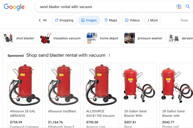

Interesting idea. I wonder if you can rent a rig that sandblasts and has a strong shop vac integrated into it to capture most of that dust and sand/beads/whatever...
Likes Tom.G
Looks likes they do exist...
