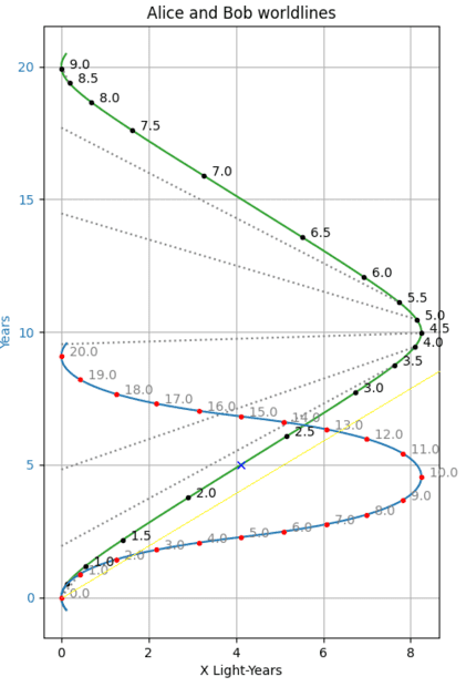

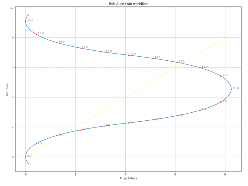

In that post I wrote:
I attach both Alice and Bob's worldlines. For the Alice worldline, remark that the coordinate speed of Alice is faster than the coordinate speed of c, but I think that the "real" speed of light line should be drawn as ##c \cdot (1+\frac{g \cdot x}{c^2})##, as for Bob in the origin of a non-inertial frame, the "speed of light" will be dependent on the position in which "the photon" is located relative to Bob. Someone could confirm this point?
Unfortunately, that was unanswered and unconfirmed, although it seemed to me and interesting question :frown:. Anyway, the v in equation (5) is the coordinate velocity, and is not equal to the velocity Alice observes from Earth.

I must consider that the coordinate velocity of Alice is cero,
This is not correct. Alice's coordinate velocity is not zero.

I will try to explain what happens more briefly. Let's say that the accelerated voyage from Earth to planet X takes 5 years for Bob's proper time (Alice's proper time will be greater, we know).
If Bob uses the metric for the accelerated frame, and integrates over the Alice worldline using the equation (5), the result is... 5 years. You only get Alice's proper time (for example, 10 years) if you consider that the coordinate speed in the equation is zero. You can check it by yourself if you want.
In other words, the result I obtain is that the arclength of Alice worldline - Alice is who moves from Bob's perspective - using the metric is... the Bob's time, not the Alice's time.
Bobs's time##= \int_{0}^{t_2}\sqrt{\left( 1+ \frac{g \cdot x}{c^2} \right)^2 \, - \frac{v^2}{c^2}} \cdot dt \quad (5)##
I think I messed up a little the use of the times translating to LaTex in the post, but originally it's done using wxMaxima. I can attach the wxMaxima file if you wish.

OK, so first issue is here. Since Bob "stays at rest at the origin" then in Bob's accelerated frame his worldline is ##(t,x,y,z) = (\tau_B,0,0,0)## (I am going to use units where ##c=1##)

First thing to be cautious. The velocity in equation (5) is the coordinate velocity in Bob's accelerated frame. I attach one of the graphics I used in my thread, from where you can see that the coordinate velocity of Alice is... more that the speed of light. So, go figure.
There is generally no issue, if a coordinate-velocity is greater than the speed of light in a non-inertial frame. SR postulate #2 refers to inertial frames.
For Alice's velocity with reference to the accelerated rest-frame of Bob, it is the case because the velocity is effected by "gravitational" time dilation. Maybe, my calculation in the accelerated frame helps:
Sagittarius A-Star said:
I didn't plausi-check your integral numerically, but I get one, which can be calculated symbolically.
Yes, I realized on reading your post that I left out some of the ##1 / g## correction terms in my post. I have now edited my post #12 to include those terms, and that gives me the same integral you got.
Lluis Olle said:
I didn't derive that equations. I just use the set of equations that are in the Wikipedia article.
You can't just blindly read equations from Wikipedia. You need to actually understand what you are doing. Clearly you don't, and you apparently are either unable or unwilling to consider the feedback you have been given and correct what you are doing.
