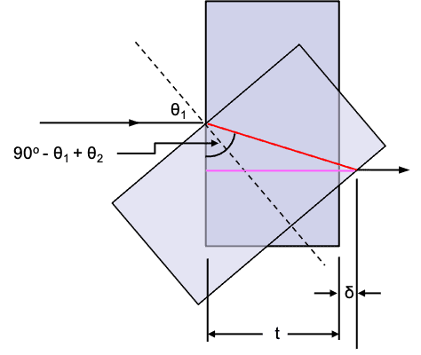

My middle term differs from yours. I have$$\Delta=\frac{2 t}{\lambda _0}\left[\frac{n_2}{\cos \left(\theta _2\right)}-\frac{n_1 \cos \left(\theta _1-\theta _2\right)}{\cos \left(\theta _2\right)}-\left(n_2-n_1\right)\right].$$I have kept ##n_1## which you set equal to 1 and my ##n_2## is your ##n##. My angles of incidence and refraction are, respectively ##\theta_1## and ##\theta_2## and from Snell's law ##\sin\theta_2=\dfrac{n_1\sin\theta_1}{n_2}## and ##\cos\theta_2={\sqrt{1-\left({\dfrac{n_1\sin\theta_1}{n_2}}\right)^2}}.## The drawing from which this is derived is shown below. It is drawn to scale with tilt angle ##\theta_1=50^o##, ##n_1=1## and ##n_2=1.44##.
The paths for the two arms are the same up to the point of incidence. The relevant horizontal distance over which different things happen in each arm is the magenta segment. Anything outside that magenta segment is the same for the two arms.
In the tilted medium the red segment has length ##\text{Red}=\dfrac{t}{\cos(\theta_2)}.## The magenta segment is $$\text{Magenta}=\text{(Red)}*\sin[90^o-(\theta_1-\theta_2)]=\frac{t\cos(\theta_1-\theta_2)}{\cos(\theta_2)}.$$Note that the magenta segment is always greater than ##t##, therefore in the untilted medium arm we have light going length ##t## in the medium ##n_2## and length ##\delta=\text{Magenta}-t## in medium ##n_1##. Then $$\Delta=\frac{2n_2 t}{\lambda_0 \cos(\theta_2)}-\frac{2n_2 t}{\lambda_0}-\frac{2n_1}{\lambda_0} \left[\frac{t\cos(\theta_1-\theta_2)}{\cos(\theta_2)}-t\right].$$ OP's equation does not have the third term in the equation above that arises from considering segment ##\delta## in the figure.

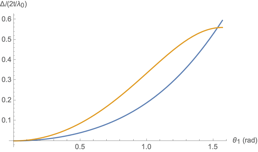

The plot below shows ##\Delta## in units of ##2t/\lambda_0## vs angle of incidence ##\theta_1## for my equation (blue line) and OP's equation (brown line). The parameters of the plot were ##n_1=1## and ##n_2=1.44## to match the drawing.
As aside it looks like we may have lost the OP, but I enjoyed doing this even if it doesn't match OP's physical situation..
Likes Charles Link
@kuruman We are in agreement. I used different subscripts on my angles, but if you read my post more carefully, I think you would find that we do agree. (You also divided by ## \lambda_o ##, but that is ok).
Meanwhile good job. :) From your graph, it is clear the OP's formula has a substantial error, if you have the scenario correct, and I would have to believe that you do.
We could use some data from the OP of positions of maxima as a function of angle, and see if the graph of maximum number ## m ## vs. ## \theta ## has the same shape as your blue curve. It could also be interesting to get a number for ## n ## of the material, and an independent measurement, and see if the formula that we came up with gives an accurate and precise value for the thickness ## t ##.
Likes kuruman
I divided by ##\lambda_0## because my ##\Delta## is meant to be the number of fringes that pass a fixed point on the pattern as the angle turns. Yes, I agree it would be interesting to have more information from the OP on this.
