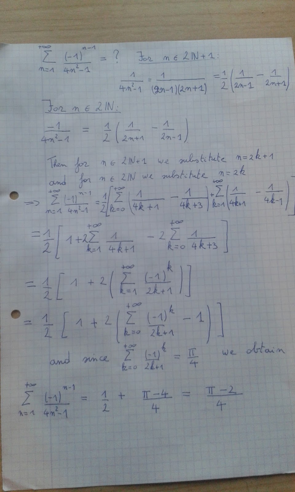

  2. SOLVED BY Math_QED ##\sum_{n=1}^{+\infty} \frac{(-1)^{n-1}}{4n^2 - 1} = \frac{\pi-2}{4}##

2 quick questions, as I am not familiar with infinite products.
1) Is the limit k-> infinity from the kth partial sum equal to the infinite product?
2) If I would have found a partial product, do I need to show this is the real partial product?
The infinite product is defined as
[tex]\prod_{i=1}^{+\infty} a_i = \lim_{n\rightarrow +\infty} \prod_{i=1}^n a_i[/tex]
Not sure what you mean with your second question.
