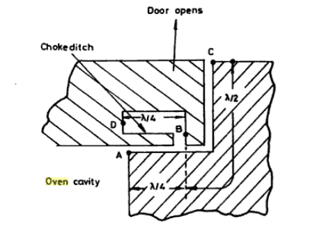

First, there is a common misconception that a microwave oven is a Faraday cage. It is not. Not even a close approximation. Go in your kitchen and open the door of your microwave. Look at the mating surfaces between the door and oven. There is no bare conductive metal at all, usually power coated sheet metal or plastic on both surfaces. It is essentially *wide open* from an RF perspective except right at 2.4GHz.
Attenuation at 2.4GHz is achieved through the use of metal features inside the door that make the slot between the door and the oven look like a quarter wave reactive choke. 2.4GHz is essentially reflected back into the oven from the door/oven seam. This is why the door is so thick.
The amount of attenuation at 2.4GHz is chosen to address human safety limits for RF exposure, with no consideration for RF communications. It is generally 30-40dB,
At 30dB, 600W on the inside, enough to cook your chicken, becomes 600mW on the outside, about the same amount your cell phone radiates.
This is a *lot* of attenuation when viewed from a human safety perspective, but only a modest amount of loss from an RF communications perspective. RF link budgets for WiFi can be > 100dB.

Actually, afaik, the standing waves are pretty stable and don't shift about. The oven cavity is not many wavelengths, actually. Some ovens use 'node stirrers', which are rotating vanes in the roof to try to stir the cold spots around by modifying the standing waves. It means you can put bigger dishes and longer objects in the oven than if you were using a turntable.

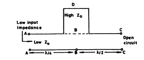

The door gap is a pretty good seal, actually. It works by a smart method which involves quarter wave slots, which acts as a transmission line 'transformer', which 'puts' a very good open circuit across the door, independent of the actual resistance of the door gap. So currents cannot flow to the outside of the case. The door gap itself is not a quarter wave and the transformer only works over a narrow frequency range (which the magnetron uses).

afaik means "as far as I know". I have attached illustration of quarter wave choke within microwave oven, and an equivalent circuit (bottom of post). This is just one particular implementation, there are numerous patents on this.
