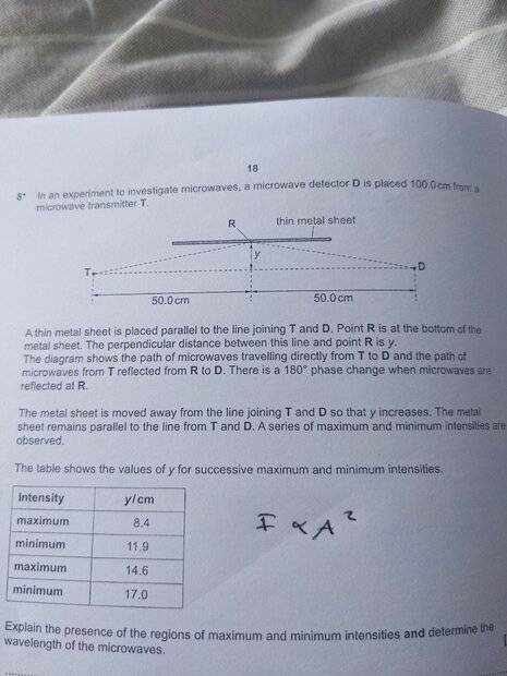

Explain the presence of maximum and minimum intensities and determine the wavelength.
I = K A ^2
V = f Lambda
I have tried to subtract the two values of y for the minimum intensities to find half the wavelength but I am really stuck.
Any help would be appreciated thanks

Alright. So I understand that the wave will be reflected and will superimpose with the first wave leading to a standing wave with nodes and antinodes. The problem I'm having is I don't know how to find the wavelength.
What do you think is going on here? Why should the intensity at the detector vary from a maximum to a minimum and then back to a maximum as ##y## is varied?
The nodes and antinodes?
And why do you get nodes and antinodes? What is going on here?
The waves "add" together while moving towards one another.
Principle of Superposition

They are not moving towards one another. The transmitter at point T emits waves in all directions. At D there is a detector that detects the superposition of two waves, one that goes directly from T to D and one bounces off the metal plate at R and then reaches D. What phenomenon is this? Hint: It starts with "I".
Interference

Forget the wavelength bit for the time being and it will sort itself out. Consider what must be true to have a maximum and a minimum. Think path length difference.
At constructive interference we have maxima where path difference is of the form n lambda , for destructive we have n+1/2 lambda.
Right. What does this suggest that you should do that would bring the wavelength into the picture?
find the path difference, but once again i am stuck :(
do i need to use pythagoras?
Distance from node to anti node=1/4 lambda
I have found the path difference for the first max but how do I know if this is lambda or not? I am unsure because when I divide the path difference of the minima by this path difference (which should be the wavelength as the first one is 1 lambda), I expect to get a number in the form n + 1/2 but I dont, can someone help/
n+1/2 (lambda) / lambda = n + 1/2 which cant be an integer but i get an integer

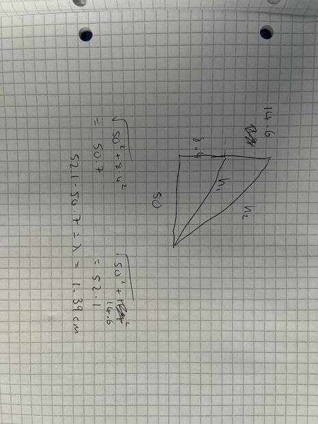

If we use the idea that the difference in distance between a maximum and minimum is ##\frac{\lambda}{4}##, then we have ##2\sqrt{0.5^2 + (0.119)^2} - 2\sqrt{0.5^2+0.084^2}## ##= \frac{\lambda}{4}## which solving gives ##\lambda = 0.056m##. If we work out the difference in distance between two maxima with the same method, we get ##0.282m##, which is consistent as this should be half the wavelength (Therefore I think that 0.056 is the correct answer).
However I would like to ask why does it not work when I try and use path differences.
If I work out the path difference at the first maxima, we have ##2\sqrt{0.5^2 + 0.084^2} - 1##, which equals 0.014m, and as this is constructive interference, should be of the form ##n\lambda##, where ##n## is an integer however you can see its not, its actually a fourth of the wavelength which is super odd as it should be an integer multiple.

If I work out the path difference at the first maxima, we have ##2\sqrt{0.5^2+0.084^2}−1##,
That would be true if there were no phase shift at the reflection.

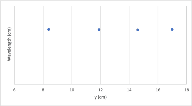

This is incorrect. Here are some recommendations to troubleshoot it.
1. Use symbols instead of numbers. The path length difference is
##\Delta L=2\sqrt{L^2+y^2}-2L## where ##L =~##50 cm. Since ##y## is also given in centimeters, there is no reason to convert to meters. That avoids conversion errors.
2. For each value of ##y## calculate a value for the wavelength. Don't forget the phase shift upon reflection. This will give you 4 separate values. I recommend using a spreadsheet.
3. Take an average of the four values.
Below I show a plot of the 4 values as a function of ##y##. I removed the numbers from the vertical axis because it is against our rules to give the answer away. However, I can say that the origin of the vertical axis is at zero wavelength which indicates that there is little variation from one value to another.
