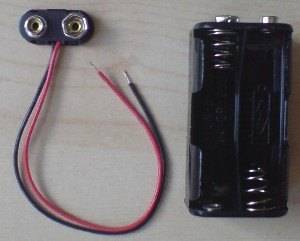

Holding the wires on the ends of a battery with electrical tape does not make a reliable connection. Just go to a local Radio Shack or similar store (or online), and get a 2xAA or 2xC battery holder. Then you can use whatever means to hook the wires up to a 2x<whatever> light bulb.
http://www.reuk.co.uk/shopImages/4-aa-battery-holder.jpg
Likes LK5

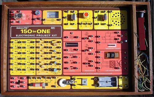

Also even more fun is the Little Bits sets:
They use magnets to create click together circuits. They even have a smart home kit where you activate the circuit via a smart device and the internet.
Likes LK5 and berkeman

Thank you for the responses and suggestions. I think I will look online for the battery holder; I'll respond with how long our bulb stayed illuminated (hopefully).
Likes berkeman
