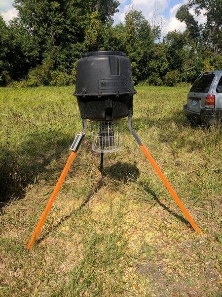

The feeders I have can be seen at http://www.cabelas.com/product/MOULTRIE-DEER-FEEDER-CLASSIC-TRIPOD-FEEDER/2249996.uts?searchPath=%2Fbrowse.cmd%3FcategoryId%3D734095080%26CQ_search%3Dmoultrie If you use the zoom feature, it is very easy to see the point of interface between the funnel and the spinner plate.
There is more to my setup than shown in that link (namely a solar panel to recharge the battery), but it does show the area of the critical parts that are being damaged, though not in great detail...for that, I will do my best to describe clearly.
Please pardon the lengthy description...
Hanging below the main barrel is an object about the size and shape of a one-gallon bucket. That is the housing for the spinner, motor, electronics that control the spinner and photo-voltaic timer, and the 6 volt rechargeable battery. Half an inch above the clear plastic spinner, attached to the bottom of the barrel, is a funnel with an opening of about 1-1/2 inches, that feeds corn onto the spinner plate, which was originally about 4" in diameter. When the spinner stops, the corn piles up, and stops flowing, as it is gravity fed.
Now the annoying part. The Raccoons have managed to eat through a substantial portion of the funnel, so that the corn no longer stops flowing when the spinner stops. There is now a 75# pile of corn below the feeder. They have also eaten the plastic spinner to the point where there is only about half of the formerly round, but now oblong spinner plate remaining. Furthermore, they have (nearly) eaten away at the strap that allows the spinning housing to attach to the barrel, as well as made inroads on several portions of the barrel's lid.
The spinner and funnel can be replaced ($20.00), but the strap can not be. I want to deny them access to the interface between the spinner housing and the barrel, as, even after I replace the spinner and funnel with metal parts, they would still be able to use those nimble hands to spill corn off the plate, for as long as they had a mind to hang there, and do so.
What I have in mind is a chicken-wire (1" holes) cage around the area, connected to the ground side of the shock device, and wrapping a positive lead wire around the parts of the plastic housing closest to the spinner and funnel, so they can be gently (though perhaps rudely) persuaded to look elsewhere for a meal. I intend to use the battery and solar panel that are already there to power the electronics.

On another note, looking at the feeder website, some models have steel wire wrapped around the dispense mechanism as a guard. Could you add this to your model? (Probably stainless steel.)
A combination of shocking and a barrier may be better than either one alone. Try wrapping two spirals of wire around the dispenser with one connected to each output of the charger. With close spacing, a shocking experience is guaranteed.

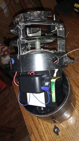

I'll have to absorb your technical suggestions, when I am more awake. Thank you for offering them.
However, your astute observation about the wrappings on those spinners is spot on. In fact, the reason I have to make the device so small, is so it can fit inside the housing. I had been thinking about a chicken wire grounding cage, but the more I look at it, the more I think I may be doing something like the lacing of ground and hot wires, as seen on some of the other brands. They sell a metal cage that fits around this one - I may buy it, and use it as the ground, still lacing a SS hot wire around the plastic parts of the spinner. An adult person would have a hard time getting their hand into the cage deep enough to get a shock, but the raccoons would still be in for a surprise.
Warning signs?...hmmm. The feeders are on private property. They are well away from the house, and the couple that live there are very well aware of what I am up to. On the rare occasion that they have guests, it is even rarer that they would entertain them more than 50 feet from the house. The feeder is almost a 1/2 mile away, and surrounded by farm fields - nary a neighbor in sight. I think it's safe to say that if someone did put their hands inside the cage, and manage to get a shock, they would be trespassing, and deserve what they got. However, as I have the attention span of a brain damaged gnat in the morning, before I get my coffee, maybe I'll put them signs up, anyways - LOL!
Whatever the final design is, it will have a switch that is easily seen, but not easy operated (like a real stiff toggle), and, in addition, I will be making it a habit to discharge (direct short) any residual charge, before servicing the spinner.

Project is complete, except for a kill switch. I managed to brush the cage with my forearm, while my fingers were close (but not touching) the positive lead. The shock had no problem arcing the 1/2 to 3/4" space between fingers and lead. I can say with great authority that the raccoons are NOT going to enjoy that experience. I certainly didn't.
As soon as I find a decent switch, this one gets installed to the feed barrel, and the other one comes home for modifications.
I'd post pictures of the completed project, but I am not a gold member, and do not have privileges to post pics.

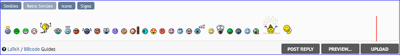

I don't think you need to be a gold member to post pictures... don't you have the UPLOAD button in you're reply box ?

Hmmm, I guess I do. I'll grab some pictures when I am deploying it in the field, or maybe when I am installing the switch I have yet to source...
