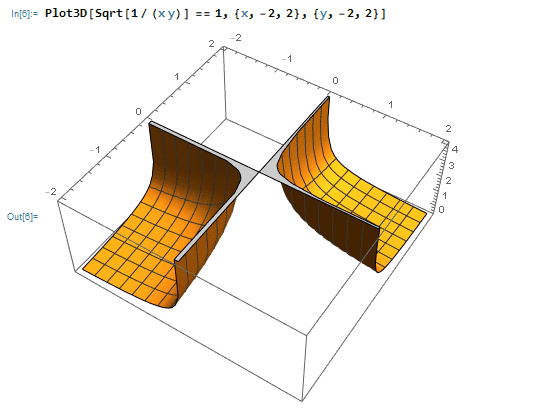

The common way to solve this problem is minimizing the two-variable equation after using the substitution ##z^2=1/(xy)##. Yet I wondered if it is possible to optimize the distance equation with three varibles. So I wrote the following equations:
Distance:
$$f(x,y,z)=s^2=x^2+y^2+z^2$$
$$\begin{cases}f_x=2x\\ f_y=2y\\ f_z=2z\end{cases}\implies (0,0,0) \text{ is a critical point}$$
But the graph of ##xyz^2## says otherwise. Why?
Thank you.

Realise it's just wrong thinking - you got your fx etc. from the s2 equation with no reference at all to what the surface you are asked about is. By that criterion the distance from the origin to every surface would be 0 !
So you need to go back to your textbook to recall what the method is.
For surface a) I get this distance to be 2√2 but I can have got it wrong too.
Likes Leo Liu and docnet

Wolfram says ##2\sqrt{2}## is correct.

This looks like a problem that can be done using Lagrange multipliers: Minimize ## x^2+y^2+z^2## subject to the constraint of belonging to the respective surface.
