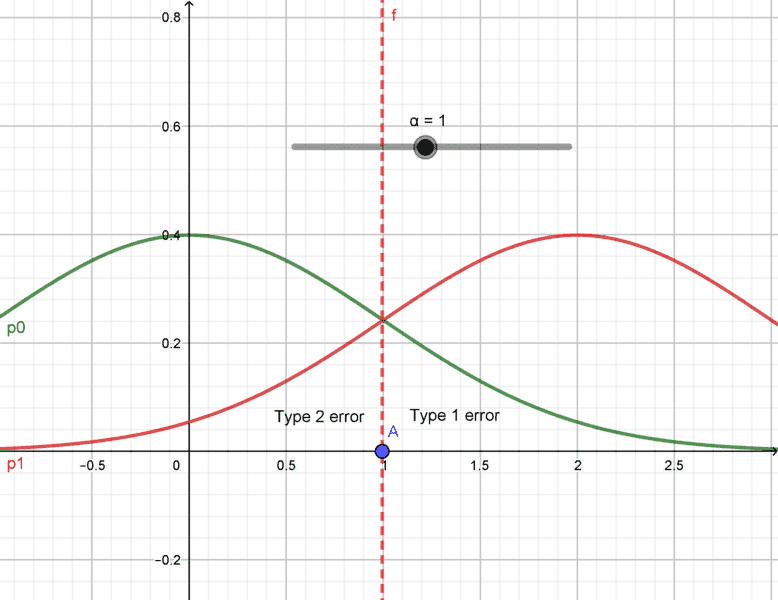

Ha! So after all that, the answer is what might have been guessed (although maybe not proven any easier):
To minimize the sum, place the the start of the rejection area half way between μ0 and μ1.
At the moment I don't have what it takes to figure it out, but there is probably a good intuitive "geometric" way to prove that.
The mid-point is equidistant between the regions ##\alpha \leq \mu_0## and ##\alpha \geq \mu_1##, for what that is worth.
Likes GabrielN00
In hindsight, now that the answer α = (μ01)/2 has been found, it is easy to see. Since the variance is the same and only the means are different, the situation looks like the figure below when α is the midpoint value. It is clear that moving α down will increase Type 1 error more than it decreases Type 2 error, thus increasing the total error. Similarly, moving α up will increase Type 2 error more than it decreases Type 1 error, thus increasing the total error. So the midpoint value is the minimum.
Likes StoneTemplePython and GabrielN00
The unusual symmetry of this problem makes it possible to solve geometrically. The analytical approach that was taken earlier is much more powerful for most minimization problems.
