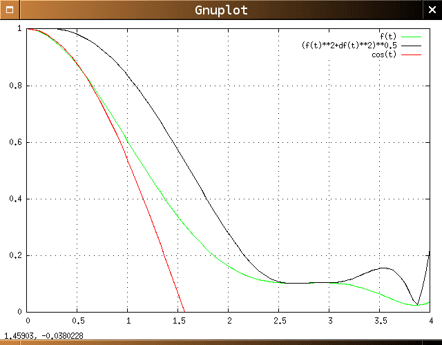

By experimentation, for example, I know that the maximum drop off rate for 's' is likely an exponential kind of function. It will be monotonically decreasing away from an initial 's' value; but eventually it will asymptotically approach some constant value (likely zero). However, attempts to use a simple curve fitter to produce a function with least error does not converge to a monotonically decreasing function.
For example, I can use 'gnuplot'; and define the following two functions and numerical derivative.
f(t)=a + b*t**2 + c*t**3 + d*t**4 + e*t**5 + f*t**6
df(t)=0.5*(f(t+del)-f(t-del))/del
del=1e-5
a=1 ; b=c=d=e=f=-1e-9
gnuplot uses a Marquardt-Levenberg algorithm, which is similar in performance to runge-kutta.
I'm not sure of the exact differences.
But I should be able to tell gnuplot to minimize the error between 's' (computed from f) and a constant of say -100. Therefore better curve fits of 'f' should make 's' with minimum height everywhere given the starting height of 'a' with zero initial derivative; eg: I removed the first power of t from the polynomial to insure that the initial slope stays zero; but otherwise, this is a generic function with fixed starting height. However, gnuplot has trouble converging generic polynomials to solutions that are anywhere close to what is expected (not only restricted to this problem; Gnuplot often fails badly when the equation is a Taylor expansion). initial values of variables affect results.
FIT_LIMIT=1e-12
fit (( f(t)**2 + df(t)**2 )**0.5 ) '++' using 1:(-100) via b,c,d,e,f
The results are not a monotonic curve which approaches zero height asymptotically / exponentially; and I don't know how much of the solution's shape is the solvers limitation and how much is my choice of arbitrary polynomial. eg: what would be a better function to curve fit ... that wouldn't diverge above theta=2.8 ?
