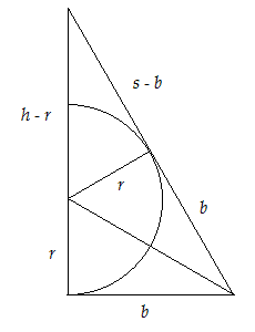

As far as what the poster at Yahoo did, they used the fact that the line through the center of the circle and the tangent point must be perpendicular to the line on which the hypotenuse of the right triangle with which we worked in the first quadrant. I have never heard of Prognathous, but I assume he meant Pythagoras.
So, let's look at a diagram:
Now the post at yahoo should make more sense. :D

What I didn't understand about the post was why the perpendicular line from the center of the circle cuts the furthest side of the triangle into $b$ and $s-b$. How do we know that it is length $b$?
I'm not sure about the significant of $h=2r$, but I do know that is impossible since the height of the triangle can't be equal to the height of the circle. That would be the case where the triangle is inside the circle.

Look at the pair of acute angles in the two triangles I have asserted are congruent. How can we know the corresponding angles are the same?

The two acute triangles are right triangles and they both share one side, which we call $h$, the hypotenuse. Then we know, by Pythagoras, that $h^2=r^2+b^2$ for the bottom triangle, and for the top triangle we know $h^2-r^2=a^2$. $a=b$. This also means that the angles are equal. I'm not sure if there's any other way to think of it.

Actually, all we need to observe is that yes, they are both right triangles, they both share two sides, so the third side in both must also be the same. And so we know the two triangles are congruent.

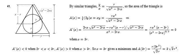

I found another solution to this problem, but very similar.
Can someone explain how that's similar triangles? I can kind-of visualize it if you flip it...

They are both right triangles, and they share an acute angle, so we know they have the same 3 internal angles, and so they must be similar. :D

Yep. Flip it and you can visualize it! (Mmm)
It means that the smaller triangle can be scaled to the bigger triangle (after flipping).
And that means that the ratio of the sides next to the right angle in both triangles is the same.
In the big triangle the ratio is $y:x$, while in the small triangle the ratio is $r : \sqrt{x^2-2rx}$.Alternatively, an equilateral triangle will have an extreme area due to its symmetry. Break the symmetry in any direction and the area will change.
Since you can also make the triangle as big as you want, by choosing a basis that is either large enough, or small enough, it follows that the equilateral triangle will have minimum area. (Nerd)

I see now that the acute angle in both right triangles are the same...but it wasn't immediately obvious. I had to work out (arbitrary) angles in my head. Anyway to quickly notice that they're similar without working out angles? I know the clue is that they're both right triangles.

Go to the top vertex of the outer isosceles triangle, and then look at the angle up there to the right of the bisector. Do you see that both triangles share this angle? :D
You need 2 clues: 2 angles that are the same.
The first is that they both have a right angle.
The other is that they have an angle in common. (Whew)
I think I know what you're saying, but not really. "and then look at the angle up there to the right of the bisector." -where does that refer?
I see what ILS is saying...both triangles share the same top angle, and the right angle, meaning that the 3rd angle must be the same! :D
