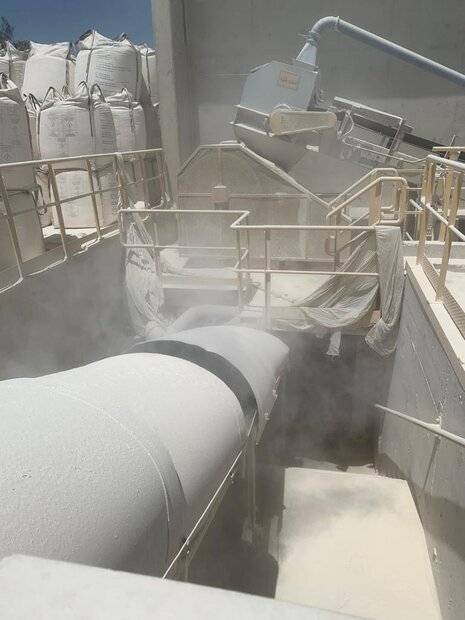

Hi Fellow Engineers
I have been tasked with a project to minimize raw material losses during handling and processing at our float glass manufacturing facility. My current focus is on minimizing sand, dolomite and limestone losses since those are the three materials that undergo separation to the required grain size before they are transferred to their respective silos.

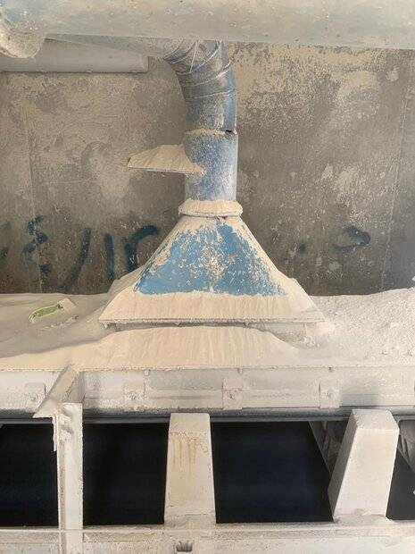

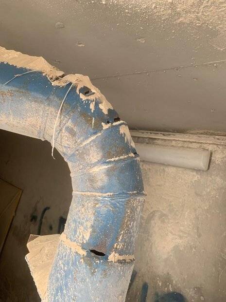

Through multiple inspections of the units I identified the following potential sources of sand loss: unloading of raw materials from trucks to stockpiles and from the bucket loader to hoppers, leaks from compressed air systems used for dust extraction and control , spillage at loading points where sand is conveyed between troughed belt conveyors through chutes or from chutes onto vibration screens or hoppers, losses from vibration screens, and fine and coarse sand particles collected in waste bins from vibration screens.
Quantifying intangible losses possess a challenge, any ideas on how one one can estimate losses from activities such as unloading to piles and hoppers, conveyance, and dust control?

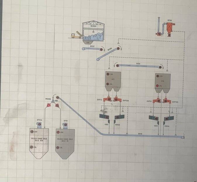

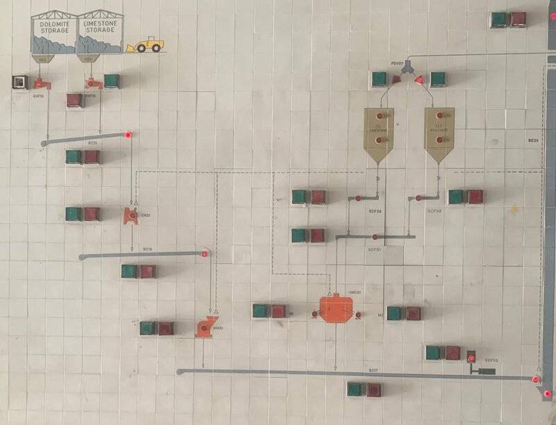

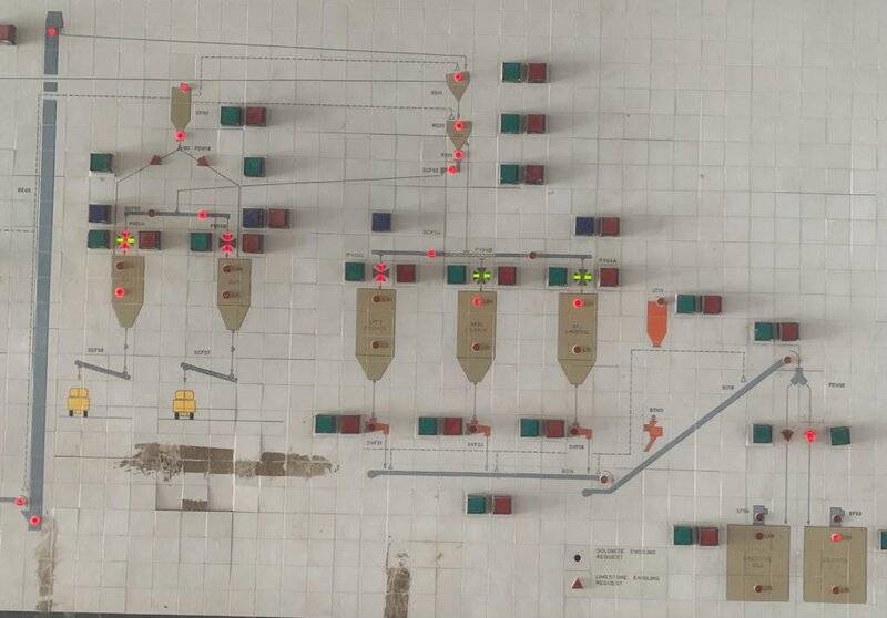

I have attached information on the ensiling of sand, limestone, and dolomite at the facility. It is worth noting that the use of hammer and jaw crushers are no longer necessary as the raw materials are now supplied within the required specifications. Dust control systems are installed at loading or transfer points where the raw material is poured from one belt conveyor to another, hoppers to belt conveyors, screw, or bucket elevator (vice versa) and covers are placed on outdoor belt conveyors.
To provide a more comprehensive understanding, I have also included some pictures of the facility. In terms of quantifying the losses, a simple mass balance can be used: Input=Raw material discharged from scales in the silos+ loading point losses+ Screening losses (fine and coarse particles) + Dust leakage losses+ unloading of raw material into stockpiles from trucks.
The Raw material discharged can be tracked by load cells under each silo (in addition to the number of batch prepared), screening losses can be quantified by measuring the weight of waste bins collecting the fine and coarse particles.

The primary objective of this project is to identify and minimize raw material losses during handling then implement appropriate solutions based on the identified potential source of loss. For example, one identified clear area of improvement to work on are the leaks from the dust control systems as seen from the pictures posted.
