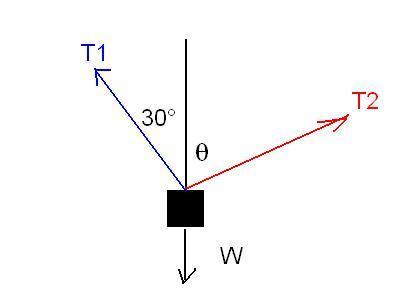

A heavy box weighing 25kN is to be lifted by 2 overhead cranes with cables inclined at 40° and 30° with the vertical respectively.
i) Find tension in each cable during lifting.
ii) Due to safety concerns, the tension T2 in second cable is to be minimized. Find the angle of inclination of this cable for this purpose.
Lami's Theorem
I'm mainly concerned with the second part of the question. Applying Lami's Theorem, I can easily find the answer to the first part. I'm sure there exists a geometrical method for the second part but I'm not sure how to start. What about triangle inequalities? Will it be of any help?

It's difficult for me to do that right now as I don't have the required softwares(MS-Paint sucks, btw!). I'll try to explain the diagram through words. Let T2 be inclined at an angle θ° with the vertical to the left side and T1 make an angle 30° with vertical on the right side. The gravitational force will be directed vertically downwards. Now, applying Lami's Theorem,
[itex]\dfrac{T_2}{150°} = \dfrac{T_1}{180°-θ°} = \dfrac{25*10^3}{30+\theta} [/itex]
You omitted the sines in front of the angles. Compare the horizontal and vertical force components, eliminate T1 and find T2 in terms of theta, find the place of minimum.
ehild
[itex]T_2 = \dfrac{W \sin 30}{\sin (30+\theta)}[/itex]
If I differentiate this wrt θ, I get θ=60°. Is this answer correct?
I got the same. You do not need to differentiate. T2 is minimum when the denominator is maximum, (as the numerator is constant) The maximum of the sine function is at angle 90°, so 30+θ=90.:smile:
ehild
