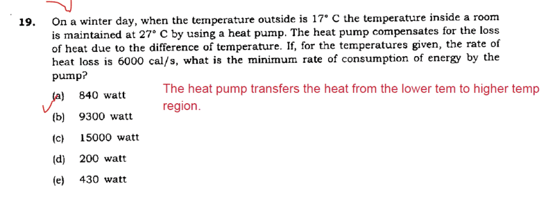

Effiency of a heat pump is given as ## \eta = \frac { T_h }{T_h – T_c} = 30 ##
W * 30/s = 6000*4.2 cal /s
Minimum consumption rate = W/s = 840 watt
Is this correct?
This formula is not quite correct. It results in only about a 3% error in this case but it could be a lot more if Th - Tc were a lot larger.
So actually none of the choices is particularly good. But maybe you picked the closest ...
The question is asking for minimum consumption rate.
For this I have to use a heat pump with carnot engine.

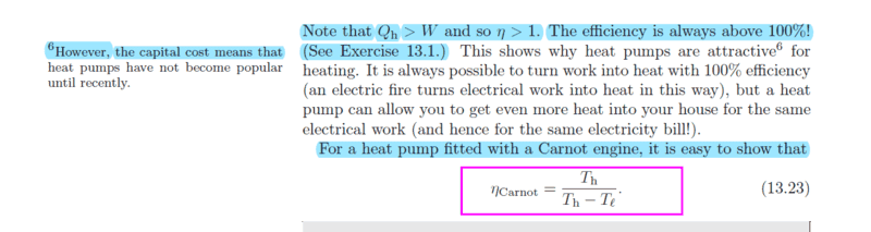

For this case, isn't the followiing right ?
Pushoam said:
Effiency of a heat pump is given as ##\eta = \frac { T_h }{T_h – T_c} = 30##
The textbook by blundell and blundell says,
OK I see the problem I think.
Your textbook defines efficiency as e = Qh/W = (Qc + W)/W for some reason.
But most textbooks talk about the "coefficient of performance" (COP) which is much more logical since this is heat removed per unit of work.
So per your textbook e = 30 but for the COP it's 29.
The word "efficiency" really doesn't apply here IMO since by definition efficiency can never exceed unity.
