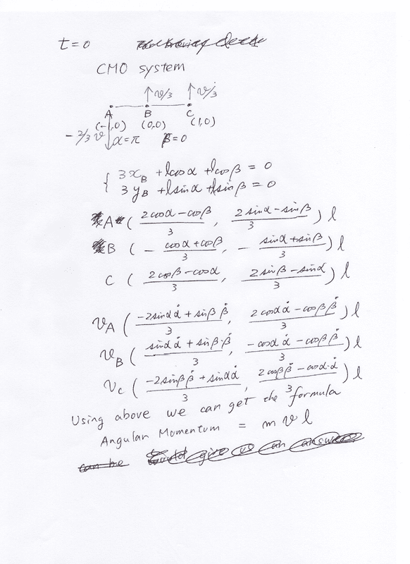

Though I have not completed it yet, take a look at my calculation attached to check your try.
Yes I think I get the same. We have defined ##\alpha## slightly differently (for instance mine takes ##\alpha = 0## at ##t=0## whilst you do ##\alpha = \pi## at ##t=0##) however this is an arbitrary choice and as far as I could tell our calculations were the same :smile:.

@etotheipi thanks for investigation. Energy conservation
[tex]\dot{\alpha}^2+\dot{\beta}^2-\dot{\alpha}\dot{\beta}cos(\alpha-\beta)=\frac{v^2}{l^2}[/tex]
where ##\alpha## is my way in post #3. Is it helpful ?

Formula of angular momentum conservation :
[tex](2-cos(\alpha-\beta))(\dot{\alpha}+\dot{\beta})=3\frac{v}{l}[/tex]
initial conditions at t=0 :
[tex]\alpha=\pi,\ \beta=0,\ \dot{\alpha}=\frac{v}{l}, \ \dot{\beta}=0[/tex]
We expect
[tex]\dot{\alpha}=\dot{\beta}[/tex]
when A and C take minimum distance. Otherwise the distance keeps increasing or decreasing. From energy and angular momentum conservation equations we get
[tex]\dot{\alpha}=\dot{\beta}=\frac{2v}{3l}[/tex] and
[tex]cos(\alpha-\beta)=-\frac{1}{4}[/tex]
which does not depend on v.
As for max, ##\alpha-\beta=\pi##,
[tex]\dot{\alpha},\dot{\beta}=\frac{v}{l},0[/tex]
For maximum two angular velocities do not have to coincident because ##(cos\theta)'=sin\theta=0## there.
I will appreciate your check and advice.

I think that looks good, the only thing I found was that I think the initial conditions in the CM frame will be ##\dot{\alpha}(t=0) = \frac{2v}{3l}## instead of ##\frac{v}{l}##, although this doesn't affect the answer.
If the angle between the rods is ##\phi = \alpha - \beta##, then for our closest distance case we will have ##\dot{\phi} = 0 \implies \dot{\alpha} - \dot{\beta} = 0 \implies \dot{\alpha} = \dot{\beta}##, as you have used.
So yes, I think you are correct :smile:, thanks!
Likes anuttarasammyak
Actually no you are right, ##\dot{\alpha}(t=0) = \frac{v}{l}##, like you said. My bad!
