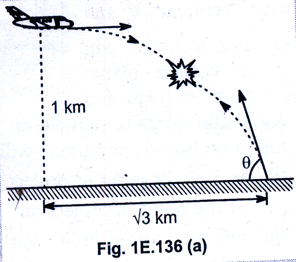

An aircraft is flying horizontally with constant velocity = ##200 m/s##, at a height = ##1 km## above the ground. At the moment shown, a bomb is released from aircraft and the canon- gun below fires a shell with initial speed = ##200 m/s##, at some angle #\theta#.
1)For what value of ##'\theta'## will the projectile shell destroy the bomb in mid- air ? If the value of ##'\theta'## is ##53^{\circ}##.
2)Find the minimum distance between the bomb and the shell as they fly past each other. Take ##\sin53^{\circ}=4/5##.
The figure for the question is as shown below:

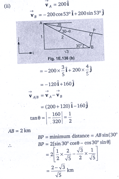

3.Book's Solution:-
Why does my answer differ from the book, what did I miss.
An image showing the initial relative positions of the aircraft and gun would be helpful. Your equation for the trajectory of the shell indicates that its x-component is in the direction of the negative x-axis, while that of the bomb is positive. If they both start at the same x-coordinate then surely they can't intersect as they would be moving in opposite directions away from the origin. So there must be some initial separation in the x-direction.

I have been trying to upload for quite some time but don't know why it doesn't get uploaded.
Finally, it got uploaded.
So according to your diagram the initial x-separation is ##\sqrt{3}~km##. You'll have to work that into your position equations.
Oh my god...that was a blunder, thanks for all your efforts.
