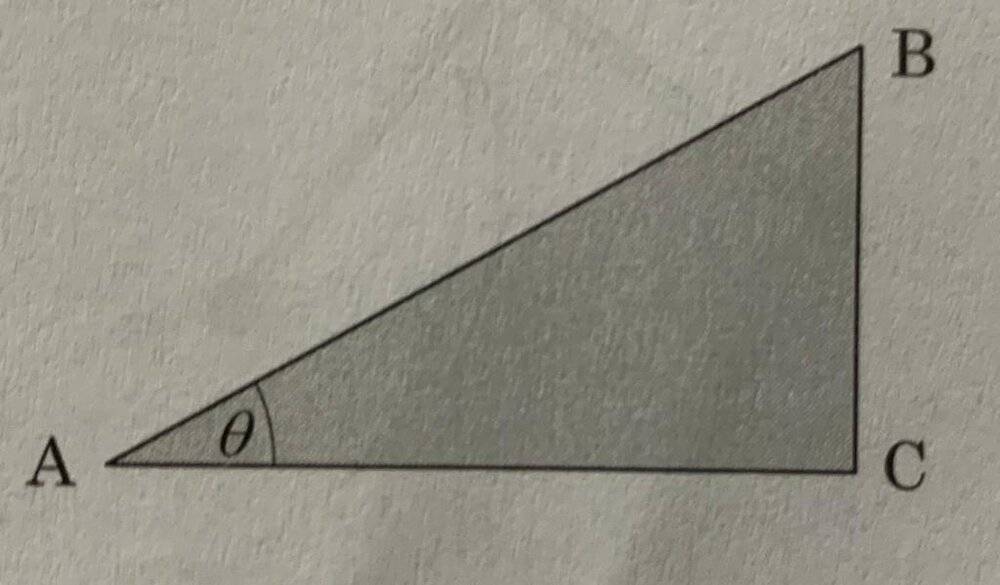

A uniform right angled triangular lamina is placed on a horizontal floor, which is not frictionless. One of the acute angles of lamina is theta. If F_A and F_B are the minimum forces required to rotate the lamina about stationary vertical axes through A and B respectively, then find the minimum force required to rotate the lamina about a stationary vertical axis passing through C.
τ=Iα
When the lamina rotates about A, FA must act on B (because it is the farthest away) perpendicular to AB (so that all of FA contributes to rotation).
Same argument is valid for rotation of lamina about B as well.

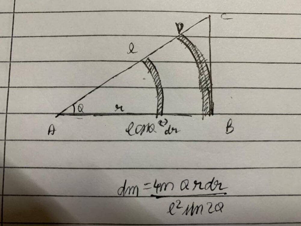

Approach 1-
If I assume that the lamina has mass m, then maximum static friction becomes μmg. FC must act on A such that it is perpendicular to AC. Then I just have to equate FClcosθ=∫dfr, where l is the length of the hypotenuse.
I can find df by writing dfr=dmαr
where FClcosθ=ICα, where IC is the moment of inertia of the lamina about C.
There are a lot of problems with this approach:
I don't know IC, I couldn't calculate it.
If I evaluated FC this way, then I would have to repeat the process for FA and FB as well, which would make the solution very lengthy.

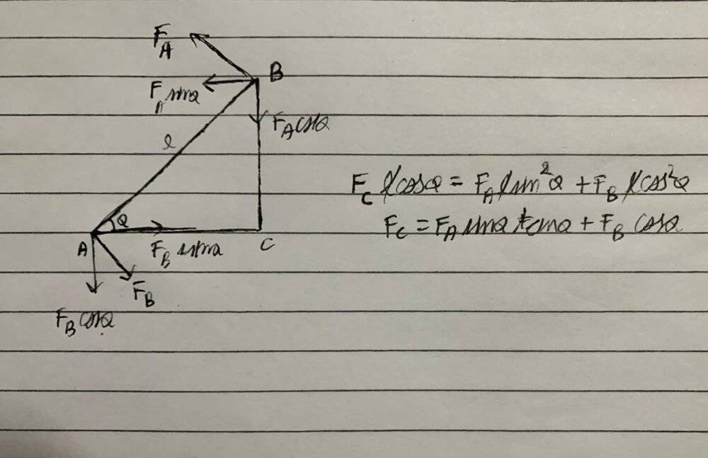

Approach 2-
While the last approach was, according to me, theoretically correct, I can't assure that for this one.
I argue that the minimum force required to turn A and B (and thus the lamina) about C must be the minimum force required to rotate lamina (and thus C) about A and B.
Then, the torque due to these forces about C must equal FClcosθ.
This approach dues give an answer, albeit the wrong one.
I think I know why the answer comes out to be incorrect. If FA or B is enough to cause rotation of A or B about C, then it can effectively rotate the lamina, and thus the answer must either by FA or B or something less than that.
Indeed, the correct answer is less than what I get from the above approach.

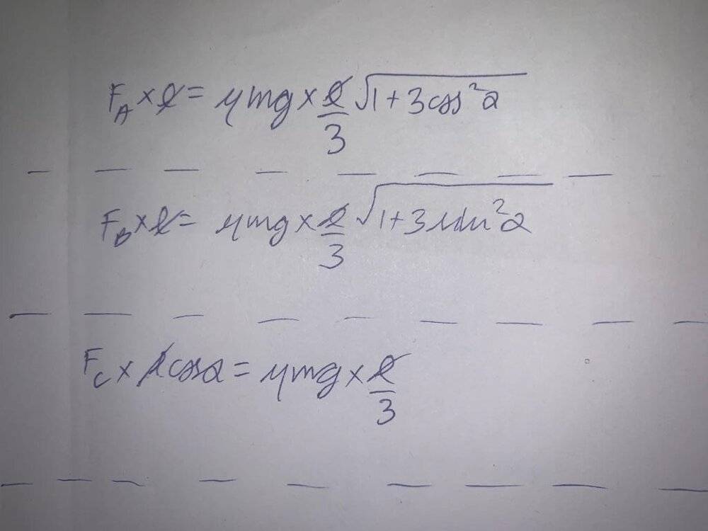

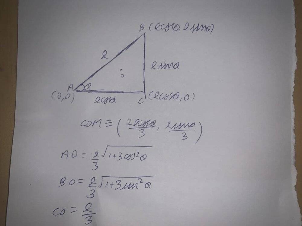

I did calculations assuming friction was concentrated at the COM.
Here are the pics:
The answer is incorrect. This approach also allows to write ##F_C## in terms of ##F_A## and ##F_B## individually (since ##\theta## is actually given), which shouldn't be possible.
In that case I'm out of ideas also. I guess you could try postulating that friction exerts an unknown maximum torque ##\tau_F## which is the same in all three scenarios and see if that gets the correct answer.
That doesn't work either, I tried it just now. Also, the torque due to friction in case of A would be greater than in the case of B and C. Thank you for your help.

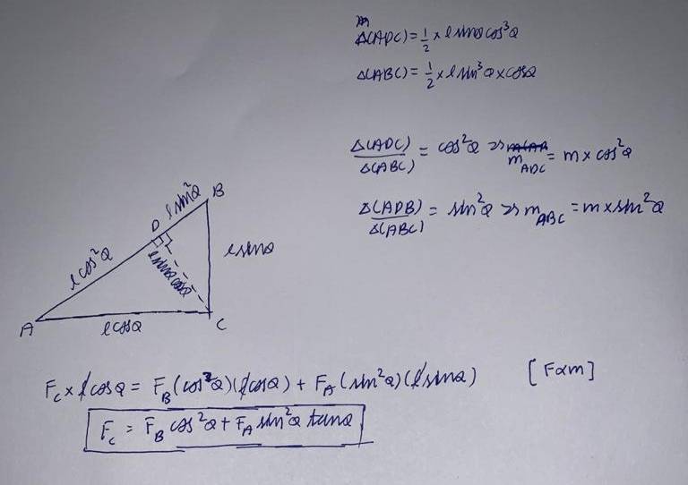

Force will be applied on A. AC is the larger side, since ##\theta## is acute.
I see a way.
Drop a perpendicular from C to meet AB at D. Consider the torques required to rotate the two smaller triangles about C.
Likes etotheipi and PhysicsBoi1908
This is very clever. Thank you very much.
It is very clever! If you don't explicitly cut the lamina there will be an internal force between the two parts. The result is that the torque you have to apply at A/B is slightly more than calculated and the torque you have to apply at B/A is slightly less than expected. But these two discrepancies will cancel exactly, and their sum will just be the same as if the lamina were not actually connected, except at the hinge (i.e. no internal force between the two parts).
