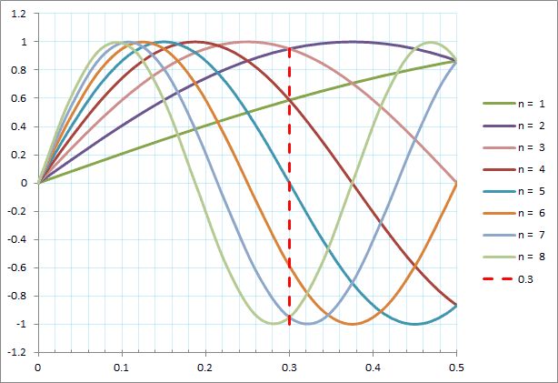

We are given a rope with a mass of 20g and length of 1.5m.
The tension of the rope is 5N, and we are holding it in the edges.
Find the minimal frequency so that a point with a distance of 0.3m from one edge will have maximum amplitude.
f=vn/2L
When I tried using the equations the only thing I could see is that it is impossible for such point to be an anti-node. In this case, how do I find the frequency? The answer is not even with the form of v*n/2L which is very confusing to me, I thought that the frequency of a standing wave must have that form?
The answer is 30Hz.
Can someone please explain how to get this? How does that even make sense?

We have the tension and the density of the mass. Sqrt(5*75) is supposed to be equal to v. 2L is 3.
The answer doesn't fit the formula of the frequency.
Is that 75 inches or 75 furlongs ?
Ah, m/kg ! so$$v=\sqrt {T\over \mu}\approx 19.4 \text{ m/s}$$
is the relevant equation I missed in your post.
75 is the length divided by the mass.
I start to see your problem. You get resonances at multiples of 6.5 Hz and never an antinode at L/5, because they occur at L/2n
Conclusion: error in the problem statement
