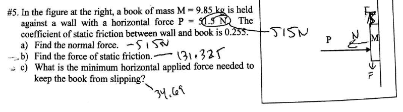

Part C of problem Please see attachment : What is the minimum horizontal force needed to keep the book from slipping. Note that P=515N, and P=normal force, Fs=131.32N, Us=.255, M=9.85kg
Fn=(m*g)/Us
My answer is 378.549N, which makes no sense becasue in the previous part my force of static friction was 131.32N. PLease help!

Your answer to b is incorrect. Keep in mind that the formula ##f_s^{\rm {max}} = \mu_s N## is a formula for the maximum possible static friction force for the two surfaces. Is the static friction force in part b necessarily equal to the maximum possible static friction force?

Why do you say that the friction force must be at its maximum value in part (b)? When ##f_s## is at its maximum value, the object is on the verge of slipping. But there is nothing in the statement of problem that says the object is on the verge of slipping in part (b).
You should be able to deduce the value of the friction force in part (b) without using ##f_s^{\rm {max}} = \mu_s N##.
Set up ΣFy = may.

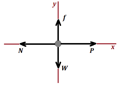

Just because two forces are horizontal doesn't mean that they have to be equal. Try to give a logical argument based on principles of physics. I have attached a free body diagram below. See if you can use Newton's second law ΣFx = max to deduce that Fn = P.

No, I thought u were talking about frictional force in part c. For part b frictional force would be Us * N. And since the book is not moving horizontally, it means the horizontal forces are balanced. So N equals P.
Also there is no need of considering max static friction in this problem. Hope that clarifies.
I agree with your answer for the normal force (515N). The book isn't accelerating horizontally so the horizontal forces must sum to zero.
For question b apply the same reasoning. First you check that the MAX friction force (131N) is greater than the force due to gravity (approx 98N). That shows the book isn't sliding. If it's not sliding then it's not accelerating so the vertical forces must sum to zero. The actual friction force is NOT 131N.
For question c...You know the minimum friction force required to stop the book sliding and the coefficient of friction so you can calculate the minimum normal and minimum applied force required.
