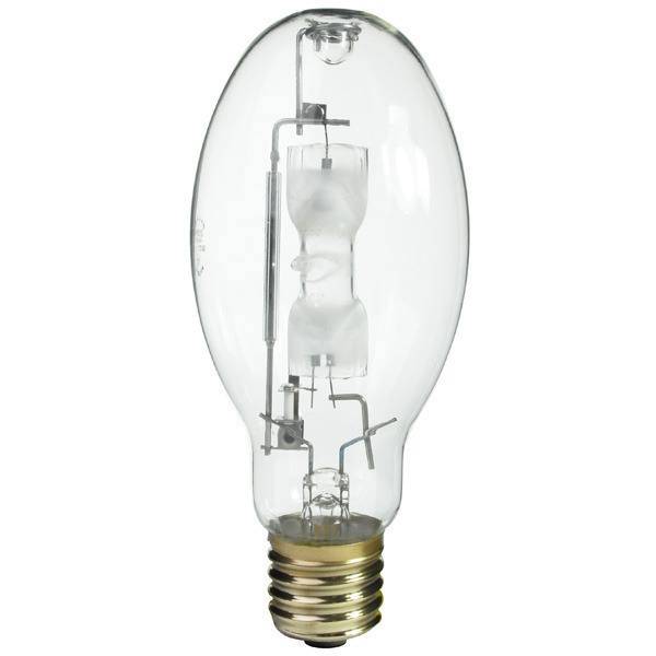

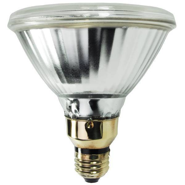

joehoy41 said:
if I had 5 lamps each producing 200W laid out evenly in a 1 meter squared area
That depends on the lamp.
This one?
Or this one?
Before you can choose how many watts you need, you need to figure out how many of those "watts" actually will hit your target. Lighting up the ceiling usually doesn't count. A separate question is how uniform the illumination will be.
