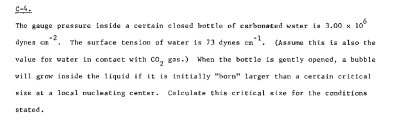

The question is from chapter 9 of "Exercises in Introductory Physics" by Leighton and Vogt.
The answer given in the book is ##R = 4.9 \times 10^{-5} \rm{cm}##.
$$\sigma = \frac{\Delta P \cdot R}{4}$$
Where,
##\sigma## is the surface tension between the surfaces
##\Delta P## is the difference of pressure between the inside and outside of the bubble
##R## is the radius of the bubble
3. The Attempt at a Solution
From the given equation, $$R = \frac{4 \sigma}{\Delta P}$$
Since the given pressure is the gauge pressure, ##\Delta P = 3.00 \times 10^6\, \rm{dynes \, cm^{-1}}##.
Replacing the values,
$$R = \frac{4 ( 73\,\rm{dynes\,cm^{-1}})}{3.00 \times 10^6\,\rm{dynes\,cm^{-1}}}=9.73\times 10^{-5} \, \rm{cm} $$
which is half the value given for the answer.
What did I do wrong?
You said, "ΔP is the difference of pressure between the inside and outside of the bubble"
The value you used was, "the gauge pressure inside <the> bottle"
But there is no other pressure value given.
And 'gauge pressure' is the pressure above the atomospheric pressure, right. So I don't need to subtract the atmospheric pressure from the given value to find the pressure difference.
From what I understand, this is what's happening. Before the bottle is opened, the pressure of the air above the liquid surface is the given gauge pressure ( ##3.00\times 10^6\rm{dynes\,cm^{-2}}##). After the bottle is opened, the pressure of the air above the liquid surface goes down to atmospheric pressure, or zero gauge pressure. But the pressure of the gas trapped inside the liquid remains the same. If a bubble is made near the liquid surface ( we have to consider the surface here because no depth is given. If a depth was given we would have to consider the hydrostatic pressure of the liquid at that depth too ), the pressure inside will be the previously given gauge pressure ##3.00\times 10^6\rm{dynes\,cm^{-2}}##, while the pressure outside the bubble is the pressure at the liquid surface, which is atmospheric pressure, or zero gauge pressure. So the pressure difference is ##\Delta P = 3.00\times 10^6\rm{dynes\,cm^{-2}}##.
Seems right. Gauge pressure is the excess above atmospheric. When the bottle is opened, that should be the excess pressure in any bubbles.
The formula you quote for the pressure in a bubble is for a bubble out in the open air. What is different for a bubble immersed in the liquid?
When you put it like that, maybe I'm wrong!
I'd thought, before the bottle is opened, the pressure inside and outside the bubble is 3 Mdyne/cm2
After it is opened, the pressure inside is 3 Mdyne/cm2 and outside is atmospheric, about 1 Mdyne/cm2, giving a difference of 2 Mdyne/cm2.
But I think you are correct in your interpretation of gauge pressure, so ΔP remains 3 Mdyne/cm2
I see Haruspex has confirmed that.
Ah, I see now! For a bubble in air there are two interfaces. From the inside air to the liquid film and from the liquid film to the outside air. But the bubble immersed in a liquid has only one interface!
So that is why you multiply by two to get 4 instead of 2 when deriving the surface tension equation! I didn't really understand it until now!
For a bubble in liquid, ##\sigma = \frac{\Delta P \, R}{2}##, which gives the correct answer!
Thanks for helping everyone!
