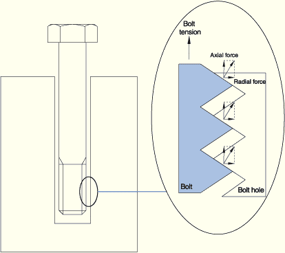

cherish said:
Does the area you mentioned is used for calculating the surface contact pressure of the mating area between threads?
It is the area of the flanks of the thread that are in contact.
Bolt tension applies a diagonal pressure from the tooth flank, into the body of the bolt or nut. The direction of the pressure is at 30° to the axis for UN or Metric threads that have a 60° profile. Since the force is applied near the tip of the thread, failure of the tooth will be by shear.
A bolt should fail in tension before the thread is stripped. The failure in tension will probably be near the shank, at the first turn of thread that is cut to full depth.

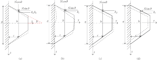

Thanks @Lnewqban,
I found a picture and a case study on the "beam theory":
https://www.researchgate.net/publication/285462605_Loading_and_Contact_Stress_Analysis_on_the_Thread_Teeth_in_Tubing_and_Casing_Premium_Threaded_Connection/link/618bfe4107be5f31b76386eb/download
But not find reference source from a book yet...

Just checked for an example of thread M20x2.5 & thread engagement depth 20mm, axial force 100 kN, approach in post #6 has equivalent stress 158 MPa while beam theory is 189 MPa, about 20% higher.
