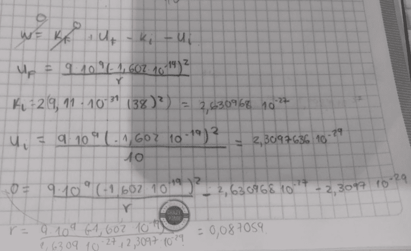

Two electrons approach each other moving in opposite directions. When the separation between the electrons is 10 m, the two electrons move with the same speed of 𝑣=38 m/s. What is the minimum distance that the electrons will approach each other before they begin to move away due to the effect of electrical repulsion?
K.E = U
It looks like you have the correct idea. I strongly recommend that you redo the problem using symbols exclusively in order to find an algebraic expression for the minimum separation ##r##. Once you have that, you can substitute numbers at the very end. This eliminates copying and round-off errors and preserves your sanity.
