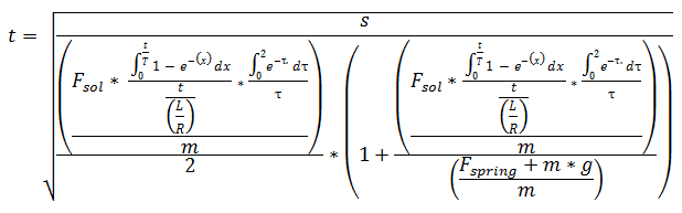

Heey guys,
I have a problem.
I want to calculate the minimum time i have to activate a (latching)solenoid so that its final velocity is 0 m/s when it hits the inside.
Well I know the following things:
F= m*a
I know the force and the mass, so a can be calculated.
V = a*t.
the average speed after accelerating is V/2(assuming the acceleration is with a constant force/speed)
i know the strength of the spring(max. 0.8N)
with that i know the deceleration speed(f= m*a) again.
if also the deceleration is with a constant speed then i know the ratio between acceleration and deceleration.
the average speed of the acceleration is known, the deceleration is assumed linear and wished to end at 0 m/s and therefor has the same average speed as the acceleration period.
i know the distance of the plunger to pull inside.(9 mm)
S = 0.5at^2. where 0.5at can be taken as the speed.
s = v*t
Because we know the ratio between acceleration an deceleration we know how long the deceleration will take to hit 0 m/s again.
This would make s=v*t*(1+Ratio). 1 = acceleration time, ratio is de deceleration time.
s=v*t*(1+ratio) => S = 0.5at^2*(1+Ratio).
rearrange so that time becomes the subject: t=√(s/(a/2*(1+R))
This gives me te answer of 2.9ms while in reality i have to power the solenoid for atleast 11ms, i did not include the pull force when the plunger closes into the solenoid. (this would make the power time even less).
neither did i include the inductance factor of the solenoid. And the friction(friction is almost none compared to the springs strength. pull force through the shaft is about <0.1N
I don't know if the plunger compresses air in the shaft and how much this force would be.
I want to know this so that i can calculate the minimum capacitance needed to power the solenoid.
for this i take the average voltage of the capacitor after 2-3T and take that as the power time. force is linear to the current through a coil and the current is linear to the voltage supplied so i can take the average of the capacitor.
But now the question:
What force do i forget that has such a huge effect on the power time.
with testing i tried using a power supply and i tried using 150uF capacitors because of their low resistance. best results with the 150uF capacitors. also tried capacitors parallel to the power supply but the power supply somehow reduced the performance except when i add a diode.
I hope someone can help me with this :)
If someone want my excel sheet they can get it. it also includes gravity when placed in vertical position.

so i found out that the inductor did have a greater impact than estimated. (when solenoid is 11mS powered)
the current limitation by the inductor is about 35% average. This included in the calculations made that the result became 8mS instead of 3, so i am jus 2-3 mS off now. i will try to find the remaining difference tomorrow. by adding 0.4N friction to the 0.2 i already have the result becomes right... but i don't think it is friction now. maybe air compression or misreading the graph of the datasheet.

Will a 2 ms current pulse of 1.45 A be sufficient to pull in the solenoid ?
i think that you forget the inefficiency of the solenoid it self. the energy put into the solenoid is not all energy that is used to pull in the plunger, that's why i use the force from the datasheet.
a pulse of 2mS 1.5Amp did not work to pull the plunger inside.
I have now included the inductors current throughput and it seems that this almost solved my problem.
the inductance is calculated by hand and can be ±20% inaccurate. so i guess it is solved now.
thanks for the help :)
i just noticed something wrong in my first post. i didn;'t use 150uF capacitors buto 15000uF capacitors.
to fully pull the plunger inside a minimum of 4700uF was needed.
//edit
my working result:
