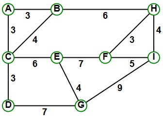

I recently wrote a program that implements a slightly modified version of Prim's Algorithm to find a minimal spanning tree and it seems to work correctly. However, I am doubtful because my prof claims that this certain tree has more than 1 solution but my program gives only one solution. Note that a different solution means that different edges are used to visit every node. Using the same edges in a different order is not a different solution. Can someone please confirm this:
GRAPH:
SOLUTIONS (in each case, all the links are the same, ∴ only 1 solution):
Code:

bump, no one can confirm this?
To confirm that your solution is the only one, evaluate every possible configuration for total distance and connectedness. Then call your professor's bluff (you should).
