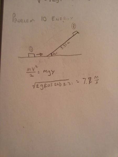

What minimum speed does a 136.4 g puck need to make it to the top of a 3.31-m-long, 24° frictionless ramp?
K=mV^2/2 U=mgY
the 'y' in your equation is the vertical distance, not horizontal. So the cos24 should be sin24
wrong its cos.
cos angle = b/c
f * s + potential energy = mv^2 / 2
edit: mistake if you want height then its sin.
if the equation is mgh = mv^2/2 then you can cancel out the mass.
gh = v^2/2
9.82 * 1.35m = v^2 / 2
26.5 =v^2
v = 5.15m/s
but it think this is totally wrong.
You have the angle, hypotenuse and want to know the opposite side. Therefore you need to use the sine.
ahhhhh. Thanks guys i see where i went wrong you guys are awesome!
