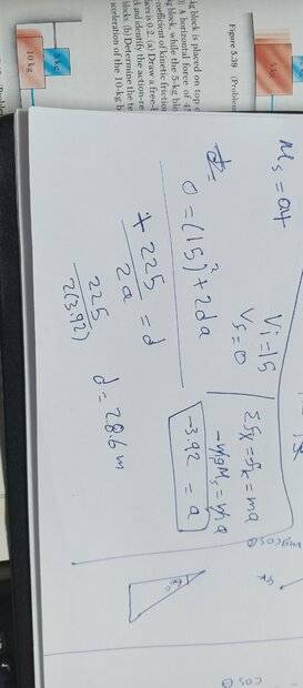

A crate is carried in a truck traveling horizontally at 15 m/s. If the coefficient of static friction between the crate and the truck is 0.40, determine the minimum stopping distance for the truck s ch that the crate will not slide on the truck.
I get d = 28.6 m
When I use Bing chat and chat gpt they give totally different answers one give 10 and one like 200 or something.
So how to solve it ?

Why do you doubt your solution? Do you see anything wrong with it?
You have the chat solutions. Do you see anything wrong with them? Why don't you post their solutions here for us to see and help you figure out who is right and who is wrong?
Note: If you must post photos in the future, please make sure they are right side up.

Now chat GPT gives me same answer I got (now I feel confidant with it which is d = 28m)

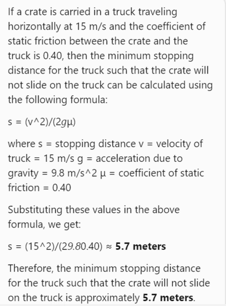

Bing chat gave me this:
I doubted my solution because I thought AI will do it better and after trying more than a problem it seems that AI gives different answers in different times so it's not reliable to give you final answer that I need because my textbook only provide final answer for odd numbered problems (physics for scientistic and engineers 1992 edition)
Fascinating. Bing chat turned 2x9.8x0.4 into the mess 29.80.40 and thence into 40, or thereabouts.
