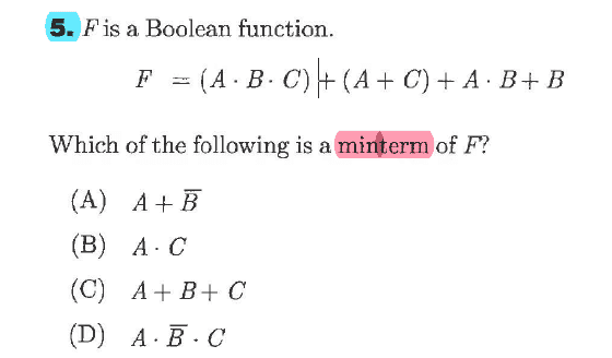

Determine the minterms of F
Definition of minterm: A standard product term, also called a minterm, is a product term that includes each variable of the problem, either uncomplemented or
complemented.
I simplified the given function into a single minterm and a single maxterm
F(A,B,C,D) = ABC + (A + B + C) + AB
F(A,B,C,D) = AB(C+1) + (A+B+C)
F(A,B,C,D) = AB(1) + (A+B+C)
F(A,B,C,D) = AB + (A+B+C)
The only terms that involve a logical AND operation are AB as (A+B+C) is a maxterm of the function.

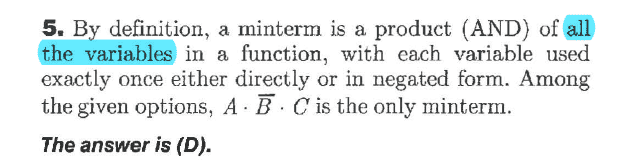

I am not sure if simplifying the function is necessary here and if I'm not supposed to for whatever reason I would think that either (AB) or (ABC) from the original function F(A,B,C,D) would be correct. Maybe ABC would be the best option because it includes all variables of the function. Regardless, none of the available solutions match what I believe the solution is and upon looking at the posted solution in the book it says AB'C is the solution. I'm totally lost as to where this minterm actually came from as it doesn' even appear in the original function. Is there some sort of algebraic manipulation going on here? What am I not seeing?

Can you see that when it's the one letter by itself there is an entire group of four. When you eliminate a letter it becomes a smaller group of just two; lastly the very specific term ##ABC## it's just standalone only one on the k-map.
I think you can use the same approach with your equation. You have an ##A## by itself; you also have a ##B## or ##C## by itself. I'm expecting that there should be a lot of 1's on your k-map. Then the other terms they are just a group of one or two.

Once you fill out the map, then you'll see all of your minterms no problem.
