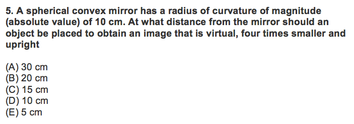

I chose D…but I don't think it's right…
I did this:
Given:
R = 10 cm
f = -R/2 (since it's convex) = -10/2 = -5
do = ?
M = +4 x (image is upright)
di = -? (image is virtual)
M = -di/do
4 = -di/do
di = -4do
1/f = 1/do + 1/di
1/(-5) = 1/do + 1/(-4do)
-0.2 = 1/do - 1/4do
-0.2 = (4/4)1/do - (1/1)1/4do
-0.2 = (4 - 1)/4do
-0.2 = 3/4do
4do = 3/(-0.2)
4do = -0.6
do = -0.6/4
do = -0.15
Is the answer C? (I chose D originally and I can't change my answer….but now that I've worked it out step by step i think the answer is C)

I did this:
Your result is very small (0.15 cm), there has to be some error in the calculation. I found one here:
4do = 3/(-0.2)
4do = -0.6
I did this:
Given:
R = 10 cm
do = ?
____________________________
M = -di/do
4 = -di/do
di = -4do
1/f = 1/do + 1/di
-0.2 = 1/do - 1/4do
-0.2 = (4 - 1)/4do
-0.2 = 3/4do
4do = 3/(-0.2)
4do = -0.6
do = -0.6/4
do = -0.15

Your magnification is wrong. It's 4x smaller, which means ##\frac{d_i}{d_o}## should be less than one since ##\frac{h_i}{h_o}## is reduced.
Oh goodness...
So what should M equal?
riseofphoenix said:
Oh goodness...
Well, it's 4x smaller so what do you think?
I'm sure you can figure this out. Other than that there seems to be nothing else wrong with your calculations.
Well, there is a calculation error in the first post, I mentioned it in post 2:
4d0 = 3/(-0.2)
4d0 = -0.6
