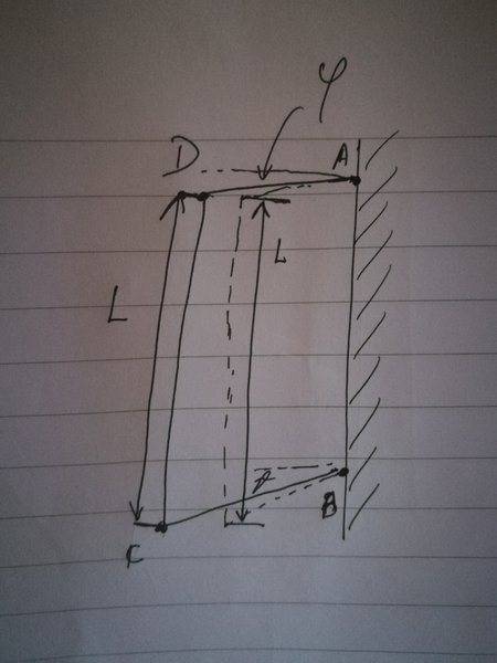

So imagine 4 rigid rods connected together to form a dashed quadrilateral as shown in the picture.
Now AB is fixed, can not be changed in anyway, while all other sides (AD, BC and CD) are connected but can move freely. The initial conditions (dashed quadrilateral) are given.
Now we rescale the dashed BC and AD sides to given values. Note that the length of CD remains constant!
Find coordinates of points C and D of newely generated quadrilateral in such way that the slope of AD and BC is minimally changed.
Ok so the way I see the problem I have 4 values to determine
$$(x_C, y_C)\text{ and } (x_D, y_D).$$

The forth one is the one I am struggling with. I know that the slope equals ##\tan \varphi = \frac{\Delta x}{\Delta y}## but I'm not really sure what to do with that. I'm quite sure I need to find the relation between ##\vartheta## and ##\varphi## first.
EDIT: This probably doesn't lead to a linear system of equations. I assume Lagrangian multiplier will be needed or some other method for finding multivariate extremes. I will kindly ask the moderators to change the topic title.

So
1. We start with the dashed quadrilateral from the original post.
2. Then we rescale the BC and AD - almost never for the same factor, except in special cases. The BC side is rescaled along vector ##\hat{BC}## and AD along ##\hat{AD}##. So "the slope of BC and AD can't change" applies to this step ONLY. I think this is more clear now.
3. Since the AD and BC sides were lengthened (and since they are in general not parallel to each other), the length of CD is now either to long or to short - the OP says the length of CD has to remain constant - I have to rotate points C and D to change the distance between them. And I want to rotate them in such a way that the slope of BC and AD is minimally changed.

skrat said:
minimally changes the shape of the quadrilateral (it was my interpretation that this means minimal change of the BC and AD slopes, maybe you have a better idea)
even if you fix on minimal change to slope, that is still open to imterpretation. How about rotation of each through the smallest angle, ψ (same angle for each but opposite directions)? Of course, there might be no such solution. Indeed, if one rod is extended much more than the other there may be no solution at all.
