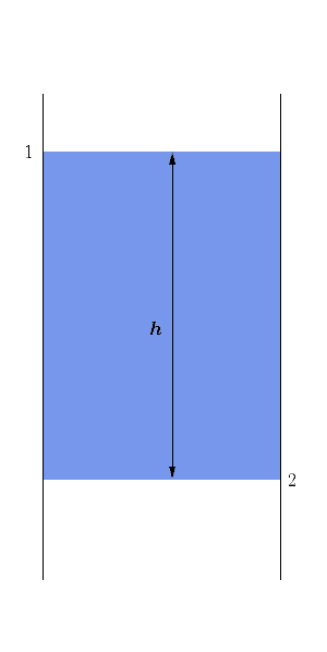

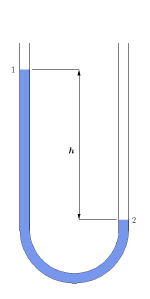

Neither of these answers seems to resolve the paradox I am getting. Here are diagrams of two other situations where the Bernoulli equation should have the same form as before: [itex]v_2^2-v_1^2=2gh+\frac{2(P_1-P_2)}{\rho}[/itex]. The first is simply a U-shaped tube with water in it at different heights (it's not in equillibrium so we expect the left level to move down as the right level moves up). The second is supposed to be a hollow cylinder with both ends open, so that atmospheric air pressure applies to both the top and bottom ends of the water. We expect the entire column of water to move downward.
In either of these, suppose we set [itex]P_1=P_{atm}=P_2[/itex] as we did for Toricelli's theorem. Then we find that the speeds are different (namely, [itex]v_2^2-v_1^2=2gh[/itex]). We know from continuity, that since the cross-sectional area of the U-shaped tube is constant, that [itex]\lvert v_1\rvert=\lvert v_2\rvert[/itex]. We also know that in the second situation, the column of water will fall together as a whole so [itex]v_1=v_2[/itex] (this also follows from continuity).
How should I resolve this inconsistency?

In your examples, what are v1 and v2? As you noted, at any point in time all the fluid is traveling at the same speed. So the only meaning you can attribute to v1 and v2 are measurements of the speed of the fluid at two different points in time.
In the first example, the velocity changes as Δh (the difference in height of the two columns) changes so the fluid oscillates back and forth. In the second example, the fluid is in freefall so the pressure at the bottom is the same as at a the top. The velocity of the whole fluid increases as the height of the centre of mass of the fluid (eg. the height above the ground) decreases. In both cases, if the velocity is 0 when Δh is maximum, [itex]v^2 = 2g\Delta h[/itex]

These are good questions. I think that at least part of the resolution lies in the fact that Bernoulli's equation is derived under several assumptions. In particular, it is assumed that the flow is "steady". This means that at any point of the fluid that is fixed relative to the "lab frame", the velocity of the fluid is constant in time. This condition is not met in your examples.

Okay, this is the first answer that seems to make sense to me (Bernoulli's principle doesn't apply since the speeds aren't constant). But I am still hung up on why in the original example, [itex]P_2=P_1[/itex].
Bernoulli's equation uses the pressure while the fluid is in motion. Inserting something in the path of the water will change this condition. The pressure of the water changes abruptly as it exits the can, it can no longer sustain the pressure it exerted while in the can. The walls and the liquid pressing down on it creates this pressure but these conditions do not exist anymore once it exits the can, only atmospheric pressure determines the pressure once it exits.
Bernoulli's equation deals with energy density of an incompressible fluid provided no energy is being added or lost. The total energy density does not change. This is due to the conservation of energy AND the incompressibility (ie. the fact that the volume does not change in any part of the flow) of the fluid.
Pressure x volume represents a form of potential energy. So P represents the PV energy density. ρgh is the energy density of gravitational potential energy. And .5ρv2 is the kinetic energy density.
Try applying that to your examples.
