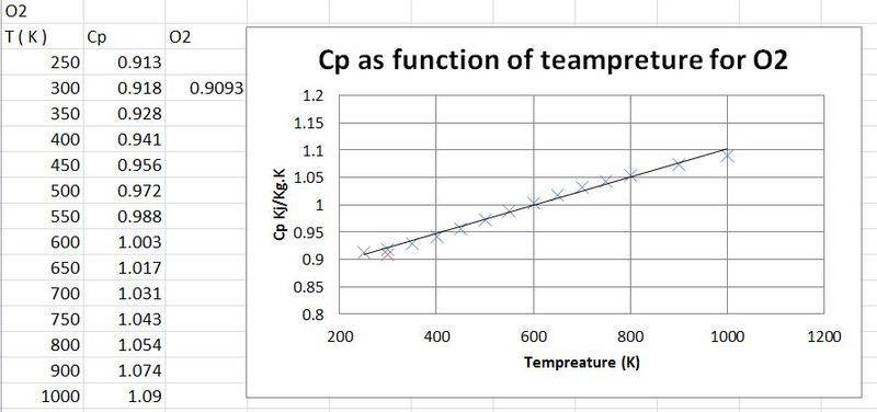

I plot the Cp as a function of temperature for O2?
the second part totally i misunderstand it i don't know what i should do

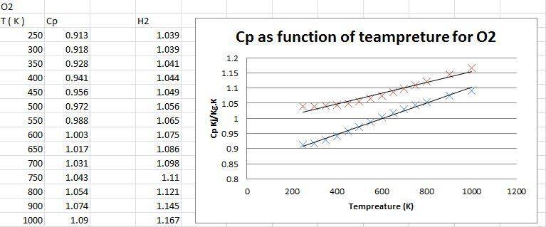

this is what i did ( see that attachment please)
if u want to see the tables (click here )
table number 2.
Looks to me like you plotted cp for oxygen vs. hydrogen. You were asked to plot cp for oxygen vs. cp for an ideal diatomic gas, which the problem states is a constant.
What is cp for an ideal diatomic gas?
I have just the general formula of diatomic !
So graph it already!

What happened to cp = 7R/2 where R is the theoretical, constant value of R?
i changed my answer. the R is constant at 300 K so i put the point at 300 K
is it now correct ?
is it now correct ?
The theoretical R is the same for all gases and is temperature-independent. But be aware that your units of R must be compatible with the units of your chart (the varying values of cp for O2.
Also, when you do get the right value for R, since it's temperature-independent, what is the correct way to graph it on your graph?
Oooooh I got it thank you very much :D I made the straight line because its constant
