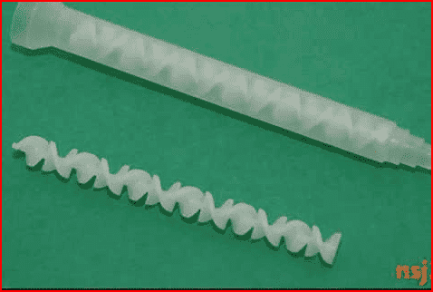

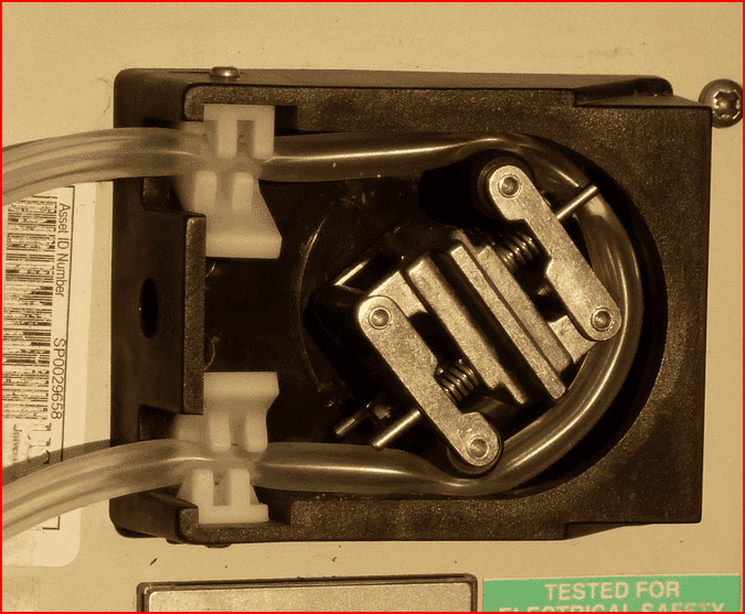

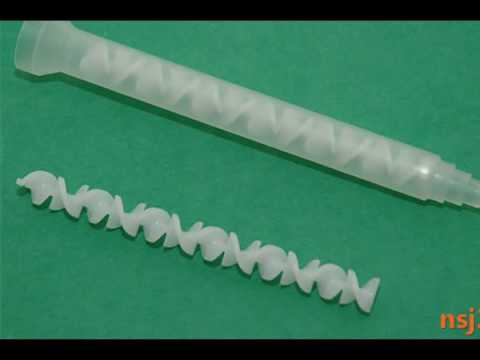

I only have a little experience with mixing (epoxy mixing for high-volume potted electronic products), but this combination can work well for some applications:
Use two peristaltic pumps to meter the flows of the two liquids, and feed the outputs into a helical mixer tube. Would that work for you?
Peristaltic pump: https://upload.wikimedia.org/wikipedia/commons/0/04/Peristaltic_pump_head.jpg
245486
Helical Mixing Tube: https://i.ytimg.com/vi/JYW6QDldODk/hqdefault.jpg
245485
