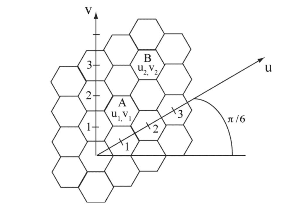

Why is the number of cells in the radius ## D ## determined by ## N_c = D_R^2 ## where ## D_R = \sqrt{i^2 + j^2 + ij} ##
area
Hi,
I was looking at some notes and trying to understand the following statement which refers to the diagram below.
"The number of cells in the radius ## D ## determined by ## N_c = D_R^2 ## where ## D_R = \sqrt{i^2 + j^2 + ij} ##
where ## i## and ##j## are the number of cells along the ## u ## and ## v ## axes respectively.
From what I understand, B is at (2, 2) in (u, v) coordinates and radius ##D## is ## = \sqrt{2^2 + 2^2 + (2)(2)} \cdot R \sqrt{3} ##. Therefore, the number of cells within the radius ## D ## should be ## 12 ##. I cannot see how this is the case, no matter how I try to encircle cells...
I think I am missing something quite simple. Any help would be greatly appreciated.

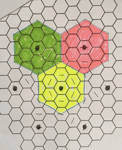

Perhaps if you study this image you will see what I mean by fractional cells. The black dots are distanced by i=2, j=2. [edited to match your original orientation]
Likes Master1022

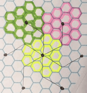

FWIW, with a change of grid origin, you can get a different cluster pattern that eliminates the fractional cells:
Likes Master1022
Thank you very much @lewando for taking the time to produce those pictures! They are extremely helpful!
