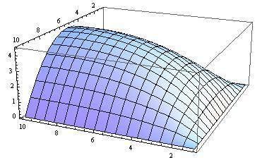

Yeah, me neither. How about solving it numerically? First consider a simplified version:
[tex]\frac{\partial^2 v}{\partial y^2}+\frac{\partial^2 v}{\partial z^2}=-1/2,\quad 0\leq y\leq W,\quad 0\leq z\leq H[/tex]
[tex]\begin{array}{cc} v(0,z)=0 & v(W,z)=0 \\
v(y,0)=0 & \frac{\partial v}{\partial z}\biggr|_{z=H}=0
\end{array}
[/tex]
Or something simple like that. So I'll set up a grid say for now 10x10, do all the difference equations on it with a spacing of one, then solve for all the internal points so that's what 64 linear equations in 64 variables. Alright, I did this quick so not entirely confident of the code but the back-substitution on the results using a sample point in the grid are close to -1/2 which is the first numeric result and the second result is the derivative with respect to z along the top edge at a select point. It's -0.07. Not zero but pretty close to what we want. So then maybe the code is workable so if you want, you can start adding complexity to the PDE and make the grid spacing smaller. When you're done with that, it's not then hard to integrate the interpolation function as you indicated above.

I can do a plot of the solution via:
Plot3D[thev[x,y],{x,1,10},{y,1,10}]
which is below. Note at the top edge with respect to z, it's almost flat which I assume is the first partial set to zero there.
Thanks a lot. The graph indeed shows the expected result, with the velocity highest midway between the shores and decreasing in the neighbourhood of the shores and bottom.
I'm going to complete it by adding extending the formula and making the grid larger. Also, since I have real data for a number of points (around 20 I believe), I could insert those in my grid and then try to find an Interpolation through all the points. I'll show some results if I have some more.
