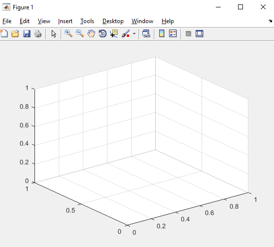

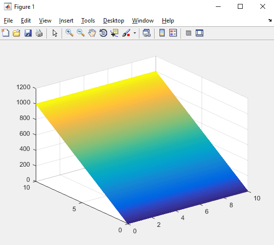

ok, I already found one mistake there was to be no x, y and i, j
Code:
for i =1:n
    for j =1:n
        u(i,j) = 0.5 + i;
        v(i,j) = 1 + 5*j;
    end
end
at t = 0
is good,
but in other cases(t=0.25; t=0.75),
my u = NaN go in and I'm stuck at this point
Why is t_max = 0?
While not related to your problem, I must say that your program if not efficient. In the brusselator functions, you should use array operations, not for loops. In laplacian, you should not have a series of ifs for border cases. Use instead a main loop dealing with core points, and then treat the border values independently.
