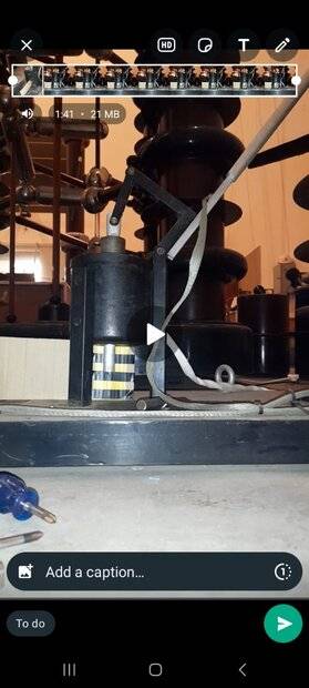

Hi All,
I am trying to model this mechanism for a project. It is a switch that uses a solenoid to break the contact by lifting the aluminium arm. I understand that there is most likely software out there that can do this but i would like to understand how to model this from first principals.
I have got a function for the force on the armature of the solenoid from an electromagnetic modeling software. The force on the armature is the input to the system. I want the motion of the armature, Y, as the output of the model.

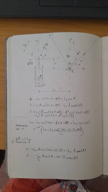

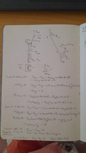

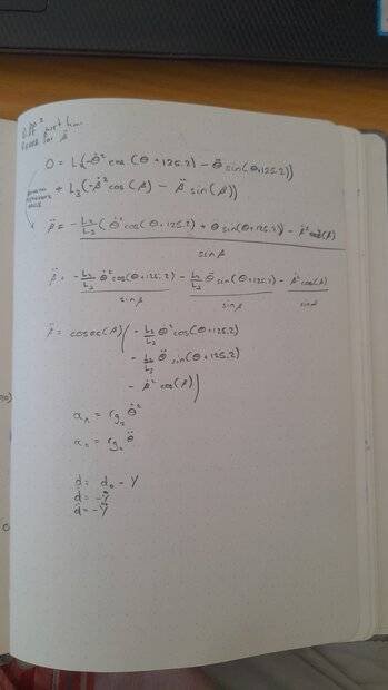

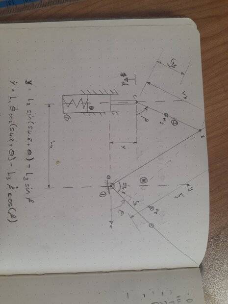

So far I have found Y and its derivatives in terms of theta and beta which are the angle of the link 2 (crank) and the angle of link 3 (con rod), respectively. I have also found beta and its derivatives in terms of theta (meaning that i effectively have Y in terms of theta). After that there is the force balance on each link. I have left friction on the armature out for now, F_mu.
At the moment I am struggling with creating the equations of motion of the armature (Ydotdot = TotalForceOnArmature/MassOfArmature). Any help would be greatly appreciated

Are you modelling the dynamic flight of the arm as a result of the predicted solenoid force, or the static force required to move the arm through, or to hold the arm in a particular position?
Originally tried to do the dynamic flight but found the algebra for that to be far too complicated. I considered a state-space approach but do not have enough knowledge to pull that off. Ended up just doing a static force analysis to find the friction between the solenoid armature and the housing, which was then iterated to get the friction as a function of the position of the armature in the solenoid housing.
And yes you are correct with the mechanics of the linkage.
The model is no longer needed but I would love to hear if there is a better approach to the problem.
