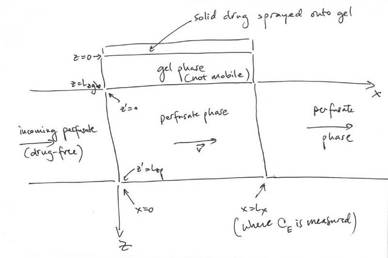

I am trying to come up with an analytical solution (even as a infinite series etc.) for the following diffusion-convection problem.
A thin layer of gel (assumed rectangular) is in direct contact with a liquid layer (perfusate) flowing with velocity v in the x direction (left to right) just underneath it. On the side of the gel not in contact with the perfusate a solid drug is sprayed. As the solid drug dissolves into the gel layer, it slowly diffuses across (in the z+ direction) into the liquid layer, from where it is transported by convection. The problem is finding an analytical expression for the exit concentration, that is, the concentration of drug in the perfusate layer at the last point on the x-axis where the gel and perfusate are in contact (x = Lx).
A diagram illustrating the system is shown below. Although the system is 3D, the solid drug is assumed to be sprayed uniformly on the (x,y,z) = (x,0,z) face of the gel phase parallelepiped so that the solution will be uniform in y at all times. This reduces the problem to a 2D one:
Several simplifications are then made. The dissolution of the solid drug into the gel is assumed to be instantaneous and by way of a superficial layer which is permanently saturated. That is, the region of the gel between z = 0 and z = δz is permanently at Cs (saturation concentration) and diffusion occurs from this layer into the depth of the gel.
Furthermore, since diffusion in the x-axis progresses much more slowly than convection, it is neglected in both the gel and perfusate phase. This reduces the problem to two differential equations, one for the gel phase, with their appropriate boundary conditions. C refers to the gel phase and K refers to the perfusate phase:

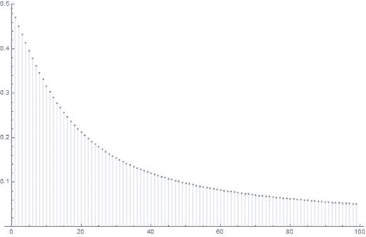

Since cot() is a surjective function on the real axis for each of its periods, there will be a unique solution for each period of cot() of the lambda-equation above, as shown below in a plot of λnLzp/√k – nπ in units of π vs. n for some typical values of the parameters:
These standing waves turn out to form an orthogonal set, which allows for determining the amplitudes much as one would for a Fourier series, and a plot of the εn is shown below:

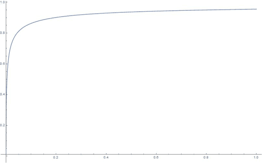

They converge nicely as n increases, which allows for determining the general solution K(x,z,t->∞) to arbitrary precision, e.g. as a function of z at some length x > 0:
This has the expected features, an oblique asymptote at z = 0 exactly matching the g(x) requirement and and horizontal asymptote at z = Lzp.

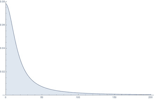

A plot of f(x)/α to show the concentration profile at the interface is below (i.e. K(x,z=0,t->∞)/α as a function of x:
