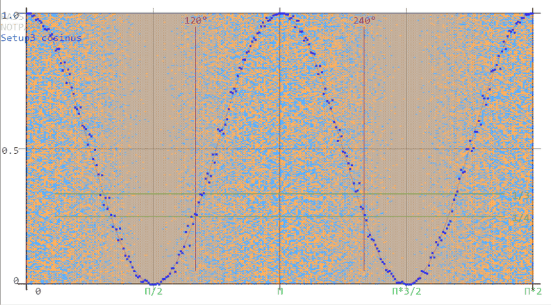

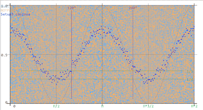

edguy99 said:
This, as I understand it, does not meet the "premise" or "assumption" of a Bell type model that you must get 100% correlation.
As far as I understand, the correlation depends only on the square of the cosine between the detectors angle, and only have 100% perfect correlation at multiple of 90 degree (for spin 1 particle if my memory serves me right)
BTW I am only aware of such simple formulas about entangled properties... this one is obviously totally independent of distance or time between measure. Maybe there are other more weird quantum entangled property state that involves time and space not just "angle". It would clearly break my "model" (which is still cheaper than a lab :wink:)Here are two graphics run of my more complete program (the horizontal axis is the angle difference, every photon plotted)
1) local (fails to emulate reality)
2) non-local (test succeeded)

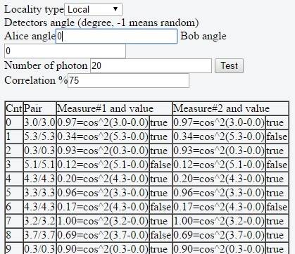

Boing3000 said:
...I don't sure I understand you. The tedious bits of comparing the matches (coincidence I guess) is done afterward, in the second main loop ...
From page 3 of the experiment "it is necessary to use coincidence detection to separate the downconverted photons from the background of other photons reaching the detectors... The setup is described in detail in the companion article."
I did a screenshot of a log of a sample run of your program with Bob and Alice both set at 0 degrees. #1 and #8 don't match. A coincidence detector would not consider these entangled and would not include them in the statistics. I think to model the Dehlinger and Mitchell experiment properly (the way they have done it), you would need to remove #1 and #8 as they are not "coincidences". I think this would also make significant differences in your graph of the "Local" mode.
That is correct, I see no way to reproduce 100% correlation with local variable (75% is the average). Does Bell's proof rely on that ?
Remember that photon true/hidden polarization is absolutely random, and only statistical average are significant (as QM and nature seem to agree)
