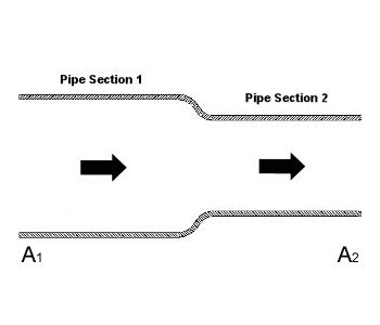

I'm currently brushing up my fluid mechanics and came across some questions while studying the compressible flow of an ideal gas using Bernoulli's equation. First, consider incompressible flow in the following system
Neglecting any changes in elevation, the Bernoulli equation for this system is
[tex]P_1 - P_2 = \frac{1}{2} \rho \left( v_2^2 - v_1^2 \right)[/tex]
And the continuity equation states
[tex]A_1 v_1 = A_2 v_2[/tex]
Now, since [itex]A_1 > A_2[/itex], then [itex]v_2 > v_1[/itex], therefore [itex]P_1 > P_2[/itex]. An increase in velocity results in a decrease in pressure. This is Bernoulli's principle.

Now, according to equation A, if [itex]v_2 > v_1[/itex], then [itex]P_1 > P_2[/itex], so Bernoulli's principle holds. However, this is where I'm having a little bit of trouble, in the incompressible case, the decrease in flow area is what caused the increase in velocity (and will always do, according to the continuity equation). In the compressible case (and again, according to the corresponding continuity equation) a decrease in flow area may not always result in an increase in velocity, since we have to take into account the change in density/pressure of the gas. In other words, for this particular system, even if [itex]A_1 > A_2[/itex] will always be true, [itex]v_1[/itex] may be greater or smaller than [itex]v_2[/itex], depending on the nature of the gas and the temperature of the system. Is this right?

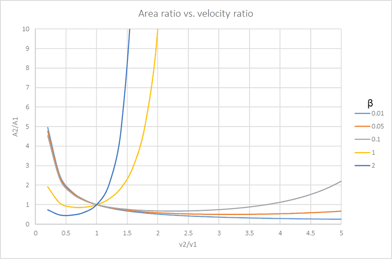

Why don't you write the equation as [tex] \ln{\frac{P_1}{P_2}} = \beta \left[ \left( \frac{v_2} { v_1}\right)^2-1 \right][/tex]
where ##\beta## is the (positive) dimensionless group ##\frac{Mv_1^2}{2RT}##? Then substitute this into the equation [tex]P_1 A_1 v_1 = P_2 A_2 v_2[/tex] and solve for ##A_2/A_1## as a function of ##v_2/v_1##. Then plot a graph of ##A_2/A_1## vs ##v_2/v_1## with ##\beta## as a parameter and see what you get.

Okay, here it is.
The system I described has the condition [itex]\frac{A_2}{A_1} < 1[/itex], so in order for the gas to flow from point 1 to point 2, it must operate at low [itex]\beta[/itex] values. If it operated at higher [itex]\beta[/itex] values the gas would flow from 2 to 1 [itex](v_1 > v_2)[/itex]. One thing that's confusing me is that when [itex]v_1 = v_2[/itex], [itex]A_1 = A_2[/itex] and [itex]P_1 = P_2[/itex], where this last equality means there is no flow, and I'm pretty sure compressible flow of a gas in a constant area channel exists. Is this happening because my model doesn't take into account viscous/friction effects? The equations are:
[tex]\frac{P_1}{P_2} = e^{\beta \left[ \left( \frac{v_2}{v_1} \right)^2 -1 \right]}[/tex]
[tex]\frac{A_2}{A_1} = \left( \frac{v_2}{v_1} \right)^{-1} e^{\beta \left[ \left( \frac{v_2}{v_1} \right)^2 -1 \right]}[/tex]

Okay, here it is.
This doesn't mean that the flow is from 2 to 1. It just means that the flow is faster at point 1 than point 2.
The last equality does not mean that there is no flow. It just means that, in inviscid flow in a pipe of constant cross section, the pressure drop is zero.
Your results are very interesting.
The reason I thought the gas would flow from 2 to 1 is that due to Bernoulli's principle, if v1 > v2, P2 > P1. Can it still flow from 1 to 2 if the pressure at point 1 is lower?
For incompressible flow, if A1 < A2, v1 >v2, and P2 has to be greater than P1 in order to slow down the flow.
Would this also mean that the flow becomes incompressible?
No. Incompressible means that if you increase or decrease the pressure, the density won't change. This flow is just such that there is no change in pressure, even though, if the pressure changed, the density would change.
