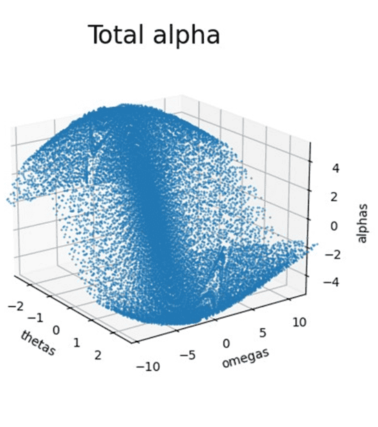

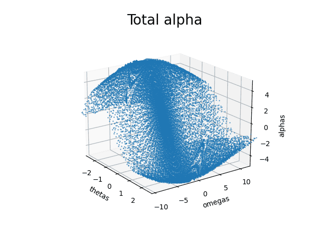

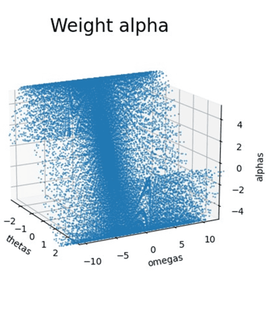

Using a precise measuring technique, I have gathered approximately 26,000 data points (θ, ω, α) detailing the movement of my rigid physical pendulum. This should be sufficient to verify whatever model you would come up with. This GIF gives an impression of the data:
Honestly, I have no idea why my data looks like this. I just can't explain away the clear but unexpected structures in the data. I expected the data to fit to this differential equation:

* ω was obtained by measuring the angular velocity with a cellphone attached to the pendulum. θ was obtained by integrating ω (with respect to time). α was found by differentiating ω (with respect to time). The experiment was repeated five times with varying initial conditions (angle and angular velocity) in order to cover more of the (θ, ω) plane. The data covers the 3D space [-πrad, πrad]x[-12.05rad/s , 13.82rad/s]x[-6.56rad/s/s 6.49rad/s/s].

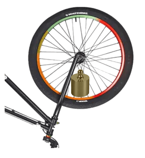

** The pendulum that I am studying consists of a ½kg weight attached to a bike wheel so that it spins unhindered around its axis of rotation. Here’s a sketch of the setup:

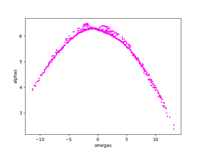

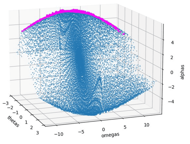

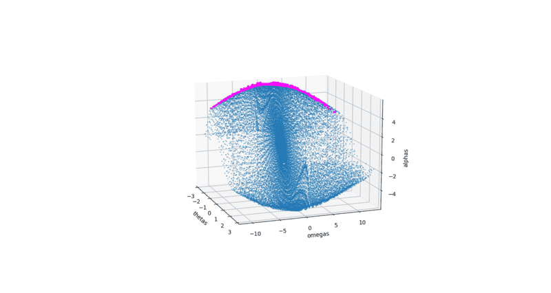

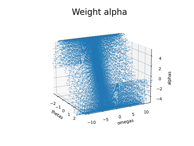

The thing with my data that confuses me the most is best explained by looking at this section curve:
This section curve shows the angular acceleration (α or alpha) for θ=-π/2rad. What I want you to notice is that α seems to be largest in magnitude when ω=0rad/s. I don't see how to include this behavior in a model, and what is worse: I don't think that this is intuitive: Why doesn't α "care" which way the pendulum is rotating when the angle is -π/2rad? It almost looks like the damping should be ω2 but I can't find a way to justify this. I understand that if the pendulum were to move downwards from this position (meaning that ω>0rad/s), the pendulum would experience a damping torque in the opposite direction (upwards) resulting in a smaller α which is what we observe. But if the pendulum were to move upwards from this position (meaning that ω<0rad/s), the pendulum should experience a damping torque in the opposite direction (downwards) resulting in an even greater α which is the exact opposite of what we observe! In other words: I really didn't see this parabola shape coming. I had expected a monovariant curve. Why isn't the sign of the damping torque opposite of the sign of ω?

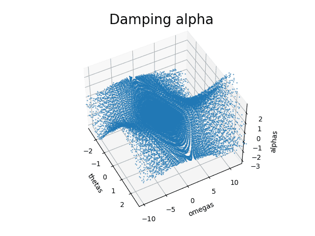

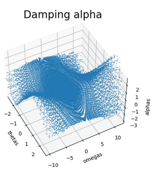

To make this even more clear I have actually found a way to isolate the damping torque (actually not the torque but τdamping*I) from the torque provided by the weight (still not the torque but τweight*I you know). This can be done because the constant mgd/I corresponds to the the partial derivative of the plot (θ, ω, α) with respect to θ evaluated at (θ, ω)=(0rad, 0rad/s):
So just to summarize my question: If the simple model provided earlier was sufficient, the dampning would be a plane instead of this curvy structure (figure named "Damping alpha). But what can explain this structure? Why is the bike wheel pendulum damped like that?
The free body diagram has a vertical force ##Mg##, a force ##Ma## in the direction of motion, and a force perpendicular to the direction of motion. The only forces that affect the angular acceleration are ##Mg## and ##Ma##, and those forces are not affected by the angular velocity. Your plot of ##\omega## vs ##\alpha## is not consistent with the theory.
When things don't make sense, it's time to look very hard at the source of your numbers. I would start by plotting ##\theta## against time, then compare the period of oscillation to the period measured by hand with a stopwatch. Also, exactly how are you measuring angular velocity with a cellphone? Please explain in far more detail than you think necessary, including a photo or diagram.
