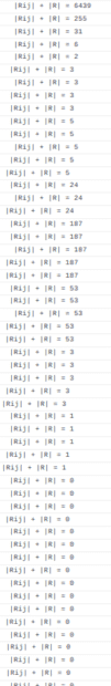

Let's try this calculation instead. The following is a rendering of ##T_{ij}## of a Schwarzchild metric:
Most of the values vanish except at a pointlike source at the center. I would now like to superpose two of these point sources, as follows:
Without prejudgement what the resulting ##T_{ij}## might look like, let's find the technical steps to do this.
##R_{ij}## is completely dependent on ##\Gamma^i_{jk}##, but ##R## depends also on ##g^{ij}## which in turn depends on ##g_{ij}##.
Suppose there are two source metrics ##g1_{ij}## and ##g2_{ij}## separated some distance apart as in the picture. What should be added to try to obtain the second picture, termwise ##g1_{ij} + g2_{ij}##? How should the distance apart be represented, since ##g_{ij}## is written in terms of ##\{r,\theta,\phi\}## coordinates from each's own origin?
What you are doing here is a linear approximation of GR, which is one option for numerical solution (generally speaking the equations won't have exact analytical solutions). Superposing multiple sources is equivalent to assuming that the nonlinearities in the full Einstein Field Equation are too small to matter for the particular problem you are addressing.
Obviously you have to adopt a single coordinate chart for the entire problem, and figure out how to transform the two metrics you are superposing into the new chart. It might be easier conceptually if you use the Cartesian form for the metric due to each source, since then you can just pick a coordinate chart whose spatial origin is, say, the center of mass of the two-body system, and the metric due to each source is then just a simple translation to put it in the new coordinates.
