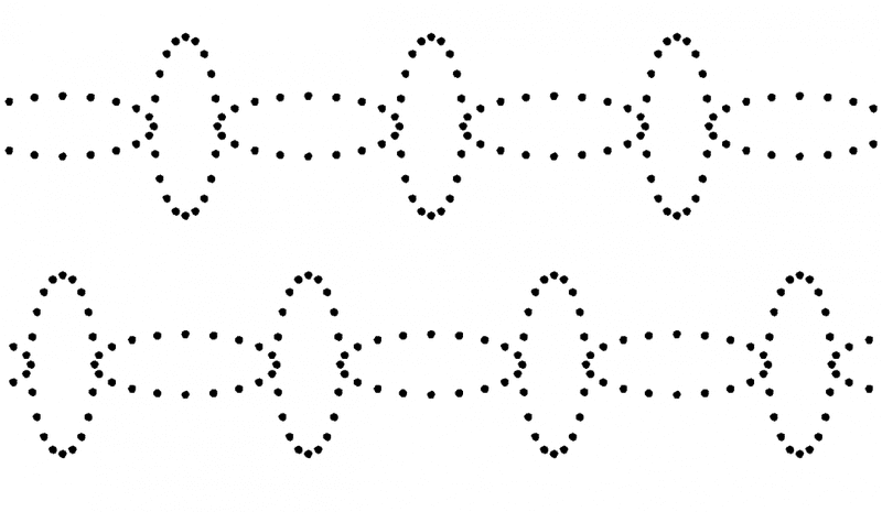

Those animations are just in a plane, to see how that is related to a wave, you need a 3D version like this:
http://www.einstein-online.info/images/spotlights/gw_wavesI/cyl_plus
Combining the polarisations might give this:
http://www.einstein-online.info/images/spotlights/gw_wavesI/gw_elliptic
Those are from this page
http://www.einstein-online.info/spotlights/gw_waves
The Wikipedia images can be thought of as a slice from the end of the einstein-online 3D tubes.
Those the effect of GW on a "ring of test particles" and I wanted to extend that to show the effect on a complete geodesic sphere enclosing a binary system system. The effect over any small region would be given by the equations in this part of the article (it's about the Earth-Sun system but the equations should be general):

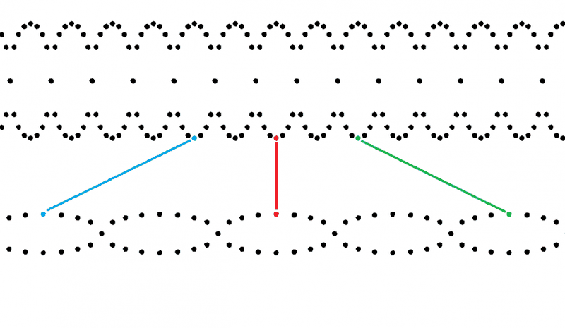

I intend to build up my understanding in steps so the simplest beginning was to consider a number of copies of the Wikipedia ring of particles with the horizontal ends sharing a particles (all are considered free-falling). It seemed to me that if one ring expanded, that next to it would have to expand too, alternating rings like this couldn't make sense:
However, if all the rings are the same, then there is not only distortion but also displacement as shown by the coloured lines relating three of the particles. The red particle is used as a fiducial datum but see later:
That view seemed to be borne out when, some months later, I saw this explanation by Rainer Weiss in the LIGO press conference. The link should take you to 23:06 and you only need to watch 45 seconds or so:

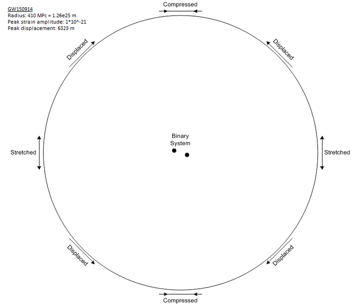

Now if we extend Rainer's mesh into a ribbon that runs completely around the GW source at uniform radius, there is an obvious problem, how can the whole circumference expand or contract? The answer is that it doesn't. The frequency of the waves is double the orbital frequency of the binary system because, in the simplest case of equal masses, it doesn't matter which star is which. That means if we see expansion then at the same time an observer on the opposite side from us but at the same radius would also see expansion while observers half way round the circle would see contraction like this:
The numbers in the top left corner are for HM Cancri, the fastest nearby binary system. Now the expanded regions are balanced by contracted regions so the proper length round the circumference is constant.To find the displacement at any location relative to our fiducial point, we need to integrate the strain around the circumference. The strain is h sin(2θ) so the integral should be -h/2 cos(2θ) but that implies no part of the circumference is static.
Putting that together as a video (the start of my ultimate goal) gives me this image of Rainer's mesh extended all the way round (not to scale, think of it as light years round, 1m high and displacements of microns):
Again, it's only 30 seconds long so please watch it, the text will make a lot more sense if you do.
So why don't we measure the displacement? My view was that the two LIGO test masses can be thought of as lying at two adjacent points on the circumference and the beam tube is essentially the chord joining them. Since the beam tube and even the whole Earth are also displaced, there is no relative motion to be detected.
It should be clear that one point will be affected slightly before the other as the band of compression (say) moves round the circumference, hence what is measured can be thought of as the distance variation caused by the slight phase difference between the masses displacements.
In case anyone thinks I'm suggesting superluminal motion of the compression band round the circumference, I'll add this similar video showing how that is an illusion and what is really happening is a transverse wave propagating out from the binary system at the speed of light:
OK, I've typed enough, can anyone tell me where have I gone wrong or is this OK so far?

(2) You can't visualize a big "ring" all the way around the source this way, because such a ring is obviously not a small region of spacetime far from the source in which a small piece of the whole GW can be idealized as a perfectly transverse plane wave. If you want to describe the global configuration of GWs on some sphere that completely encloses the source, you have to do it some other way; the linearized approximation is not valid and the visualization you are using is no longer applicable.
OK so that's where I need the help from those members of the forum who understand GR. I've integrated the widely published equations at constant radius round the orbital plane and what that gives me seems logical but the numbers don't work out in the context of an "Earth frame" so what are the equations should I use instead? As I've said, I'm not someone who thinks GR is wrong, my aim is to produce a set of graphics like the ones you've seem that shows how a complete geodesic sphere of test masses would be displaced by the GW from a binary system. Finding out how to generate the graphics is the immediate task so if I can get the equations from a textbook or web reference in polar coordinates, that will let me move on. Just point me in the right direction please.

This is extreme guesswork as is no doubt obvious, but:
  • the waves can have different rates, should f(t-z) be f(ωt-2π(z/λ)) where ω is the angular frequency and λ is the wavelength?
  • can that metric be adjusted to take account of the phase around the equator of the circle with the source at the centre by using f(ωt-2φ-2π(z/λ)) where φ is the azimuth in spherical coordinates (hence dx=R dφ and dy=R dθ with z≡R) ?

Going from this approximate notion far from the source to saying that we can do the same in the strong-field region around the GW source is a bit of a stretch. I'm rather skeptical,
I agree and I'm not trying to do that, I only want to model a spherical shell with a thickness of just a few AU and at a uniform radius no less than a thousand light years from the source. Any sort of strong field or "near field" effects (analogous to EM) are well beyond my scope.

If what you mean by polar coordinates is polar coordinates centered on the source, this will not work. The metric pervect gave is only valid in a small piece of spacetime far from the source in which the GW can be idealized as a purely transverse plane wave. That will obviously not be true in polar coordinates centered on the source.

How about three copies of LIGO-in-space separated in the z direction by λ/2, would it be possible to say how that would behave? I've attached a sketch showing three tubes as black line pairs with red test masses (not to scale, λ≈2000km, tube length=4km).
Each tube individually, with its pair of masses, should be within a "pancake" region. In that view, I think the associated tubes would stretch and shrink, equivalent to the masses moving relative to the tube ends in the more usual representation. Since the tubes containing masses A-B and E-F are a wavelength apart, I am hoping we can define a congruence in which all four are always at rest and the distances A-E and B-F are also constant.
The question then is what happens to masses C and D and their associated tube? I think there should be a third "pancake region" covering them so, within that, the relative motion of the masses and tube should be as for the other two regions (just 180 degrees later), but is your calculation able to say how those two masses move relative to the congruence in which the other four are always at rest?
P.s. I'm also assuming we are simplifying by calculating for a constant wave frequency whereas the LIGO detection swept from a wavelength greater than the diameter of the Earth to 3 times smaller in less than 20ms, and that we are just working with plane waves.

My gut reaction is that you could create a different congruence for each tube in the stack, but they would be slightly different, having different simultaneity conventions. So you wouldn't have a coherent picture of the whole stack sharing a single, common, convention of simultaneity.
