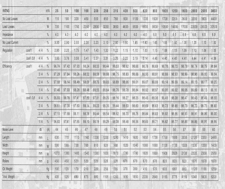

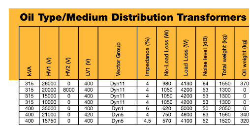

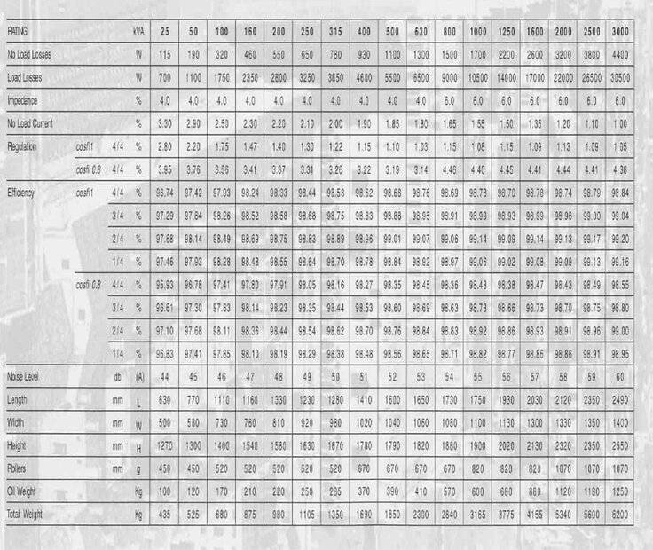

For oil filled type and dry type transformer see attached some catalogues

That's interesting. What do they mean by measuring Impedance in %? Does that represent the Leagage Inductance divided by the Magnetizing Inductance maybe? ##\frac{L_k}{L_m}##
In fact, this is the short -circuit impedance related to the nominal impedance.
The rated impedance it is Zrat=Vrat^2/Srat and Zsc=R+jX |Zsc|=sqrt(R^2+X^2) uk%=|Zsc|/Zrat*100
Likes berkeman
Actually, uk=Zsc*Irat it is the measured short-circuit voltage, indeed.
In short-circuit case the secondary impedance is very low so you may neglect the main magnetic flux impedance [considered infinite].
R it is the equivalent resistance [it depends on which side is considered the applied voltage Vrat] for instance if Vrat it is primary voltage, then k=Vp/Vs and then R=Rp+Rs*k^2 at conductor rated temperature.
X=leakage magnetic flux reactance=Xp+k^2*Xs

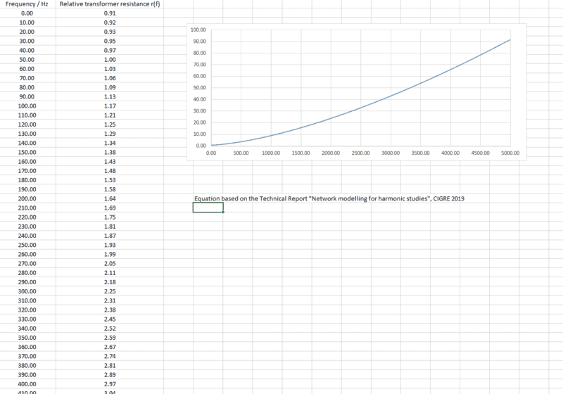

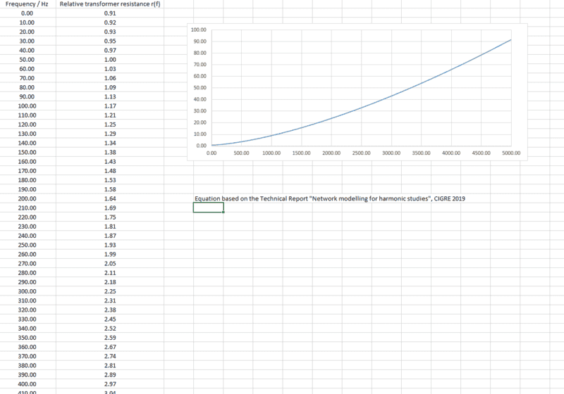

Do you have idea how transformer is modeled for simulation for harmonic studies? What i found is, series leakage inductance and copper losses are mainly frequency dependent. So to model it, one can get these parameters from manufacturer. It should be in tabulated form as sample shown.But unfortunately, the manufacturer of transformer in our lab has not performed frequency analysis on this transformer. Now my supervisor says, to get these leakage inductance and copper losses based on frequency from any other source (literature, simulation software developers, open forums or any other manufacturers). That is why i am using this forum. But the parameters you mentioned does not seem like a frequency scale characteristics of transformer. What is your comments? Maybe our discussion can give my work a favourable direction. Thanks
About the table and diagram attached:
I don't know what is "relative transformer resistance r(f)". In my opinion it could be the resistance of 75oC with respect to 105oC[ class A insulation].
However, for 630 kVA 0.4kV transformer X/R=5 and current density j=1.3 A/mm^2 copper conductor Irat=630/sqrt(3)/0.4 then Irat/j=700 mm^2 secondary copper conductor. Then 1m at 20oC copper conductor will be:
R[20oC,1m]=1/58/700=2.463E-05 ohm/m
R(105oC)=(234.5+105)/(234.5+20)*2.463E-05=3.286E-05
R(75oC)=0.911*R(105oC)=3E-05
If the conductor temperature remains 75oC then following IEC 60287-1-1 for skin effect we get approximately the table results.
For instance, for 100Hz xs=sqrt(8*pi()*100/3E-05/10^7)=2.894 ; ys=xs^4/(192+0.8*xs^4)=0.2828
r=(1+0.2828)*0.91=1.169
No proximity effect is taken into consideration.
If we shall follow the dr.Ray Ridley publication [see attached file] the proximity effect will be very high.
