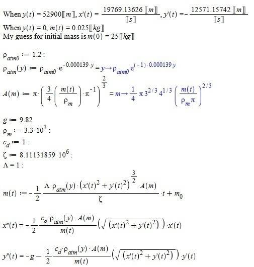

I am to model the motion of a meteor as it travels through the atmosphere, taking into account the loss of mass, which is 0.025 kg upon impact (height = 0). I also have to take into account the air resistance on the meteor, the fact that the air density is a function of height and that the orthographic projection of the meteor perpendicular the direction of movement (part of the air resistance equation) is a function of the mass of the meteor.
I assume that gravitational field strength is constant.
I have attached a picture of the equations I have been able to derive so far using standard formulas.
I have to solve the differential equations for x(t) and y(t) numerically, however, I fail to see how and therefore seek help.
This is for a very important school project and I'm running out of time, so I really need help. Even the smallest hint would be greatly appreciated!

Simply calculate it step by step in small time steps?
You know the initial position and velocity at t=0, you can calculate the acceleration there and use this to estimate the position and velocity at t=0.01s (or whatever). Use the data there to estimate the values for t=0.02s and so on. There are better integration schemes, but start with the easiest one and improve that later if you like.
Your equation for A can be simplified a bit.
The atmospheric density does not follow an exponential law as the temperature depends on height, by the way.
Newtonian gravity with atmospheric drag is not solvable analytically. Use an ordinary differential equation numerical solver. I prefer MATLAB.

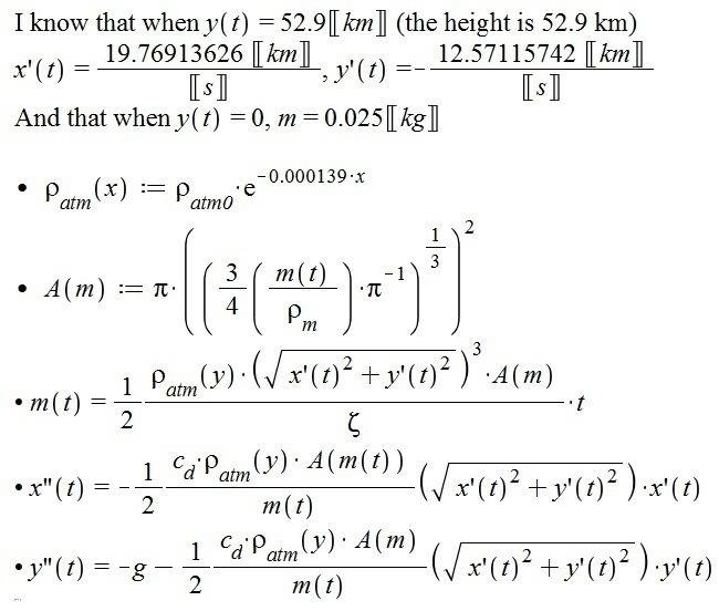

It would help if you tell us what exactly A(m), m(t), etc are. Also, what is that little squiggly variable for? Is it a constant?
This is everything
Mass as a function of time only
I don't think that equation for m(t) makes sense, it has m(t) at the right side as well, but multiplied by t and other factors. Looks like a wrong differential equation.
