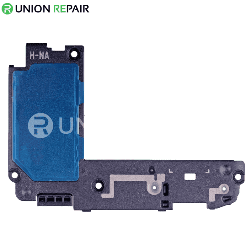

This image says it is the speaker from my S7 phone. It is not clear how many mm it is in size.

My sympathies for having hearing that cuts off at 3 kHz, that really does reduce much of what we hear (consonants in speech for example).
Without needing to go into audiophile teritory, that really does change the context of "high quality sound". Even many of us old timers would consider a source that cuts off above 3 kHz to not be "high quality". I think it would be more helpful to re-phrase this as "How do modern small speakers manage to provide fairly low distortion sound in most of the bandwidth of speech, at the volume levels they do?" It would be far better to put some numbers to that, X db SPL at 1 meter at specific frequencies. Your phrasing is really open ended.
In general I agree though, that the sound from these small speakers has greatly improved in recent years. But there is simply no comparison to a hi-fidelity speakers that are furniture size. These phones do not put out anywhere near the SPL, especially in the bass area, say even 150 Hz, let alone 30 Hz. And anything even remotely considered "high-fidelity" will be able to produce significant SPL levels at 30 Hz, even if it is rolling off. That's not the snake-oil audiophile territory, ask any musician. And I'd bet the distortion in these phone speakers, while good, is no where near as low as a hi-fi speaker.
I'll try to find some sources, but my guess is (physics being what it is), that they have managed to increase the displacement (throw) of the diaphragm over a fairly linear range. A typical dynamic speaker looses linearity as the coil moves out of the magnetic field.
