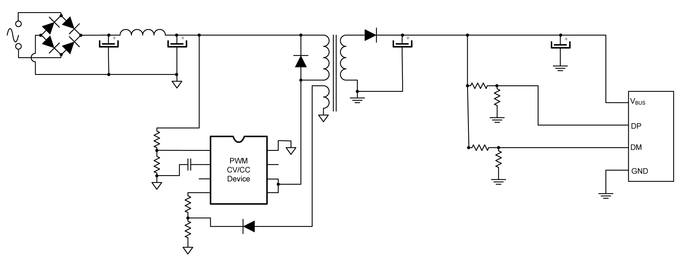

I would need to see a schematic in order to determine whether you could modify the charger to give different output voltages.
It looks like a bridge rectifier connected to the mains followed by a 1 transistor switcher of some sort.
This is typically what is done: from http://www.eetimes.com/document.asp?doc_id=1279469 In this example, resistors can be changed to affect output voltage, but this is not exactly what your charger looks like. It looks like you have a single transistor pwm circuit driving the primary of the transformer. It may be that the zener diode sets the output (you have a zener diode labeled ZD1), in which case it may be difficult to change.

It is not a linear supply. The Line voltage comes directly into a bridge, and then is switched by Q1/Q2 somehow. It is a switcher with a transistor doing PWM switching.

No way. It is the minimum number of components needed to get 5V @ Xma from the rectified AC line (through a switched transformer). You will never find a USB wall charger with any sort of battery protection mechanisms (just UL-like mandated safety mechanisms for smoke avoidance). And, they know NOTHING about what kind/size/etc of battery they are charging, or even if they are charging a battery. It is just a 5V supply. All of the battery related smarts are in the device with the battery. It has to be that way since devices have different batteries with different requirements and the charging requirements are complex.

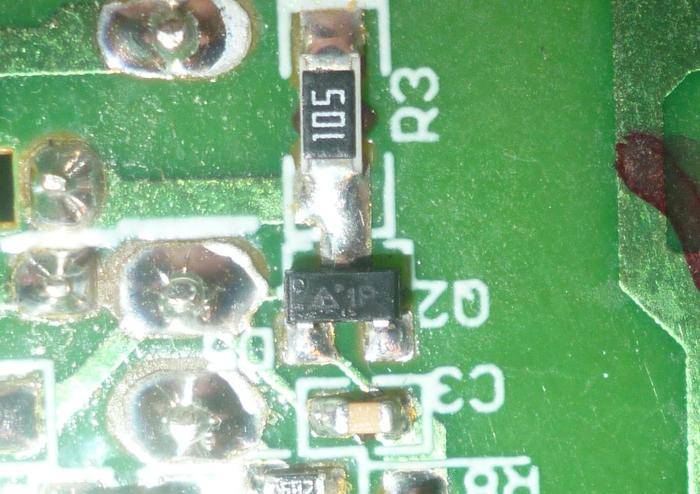

Hey there, have been quite busy, I'm sorry i didn't reply this long, I'm going to make a schematic for you guys, but for now, Q1 = T2095A
Q2 = Can't really tell, maybe you can?
Q2, a 1P is a 2N2222A type general purpose, NPN transistor
