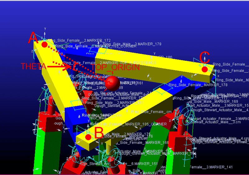

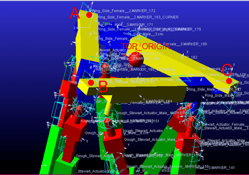

I’m building a model in a 3D simulation program (MSC Adams) and part of that model is a triangular platform which can translate and rotate in the virtual world, as shown in the 2 images below:
There are some markers on this platform that, when it is at its home orientation, are aligned with the global axis system (which is the orientation of markers A, B and C in the first image). These markers move and orient with the platform so that they represent the platform’s orientation with respect to the global axis system.
Now, I have a special marker (TOP_ORIGIN) that is coded so that it is always at the centroid of the corners of the triangle that form the platform (average of the coordinates A, B and C). What I’m trying to do is to also constrain the orientation of the marker as follows:
  • The X-Y plane is the same as the platform’s plane with the Z axis putting “up” away from the model.
  • The angle between the X axis and the vector XA is set to an angle, theta, which I calculate elsewhere.
  • The software gives me two ways of getting and setting the orientation of objects: yaw-pitch-roll (rotation about Z then rotation about the new Y, then rotation about the new X) and phi-theta-psi (rotation about Z then rotation about the new X, then rotation about the new Z).
How can I apply these transformations to get the marker to the orientation I want?
The yaw-pitch-roll transformation looks fairly standard but your description of the phi-theta-psi transformation doesn't look right. Two Z rotations is unusual, and not what I would expect from "phi-theta-psi." (P.S. I can't see what axes you are talking about because the pictures are very cluttered.)
I am not sure what you are asking, amrbekhit. Do you want to convert between yaw-pitch-roll and phi-theta-psi? Can you clarify your question?
