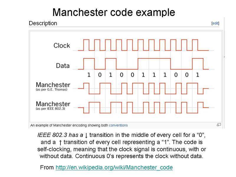

Here is an example of the Manchester self-clocking code. Between data bytes, a continuous series of "0"s produces a standby clock carrier signal that is used to synchronize the reciever (usually a phase locked loop). The recovered clock signal is then used to demodulate the data signal by shifting it into a shift register, for example two "1"s (for initializing the receiver), followed by an 8-bit byte and a parity bit, for a total of a 11 bit word. Because each bit is bipolar, there is no threshold skewing due to a long series of "0"s or "1"s as discussed by skeptic2. Creating a Manchester code is easily done by combining the clock signal and the data signal in an exclusive OR or NOR.
Bob S
